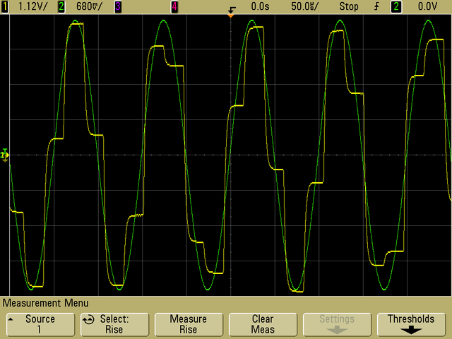

In the oscillograph below the yellow trace is the output of a non-oversampled AD1865 DAC with no output filtering. The green trace is the output of an AKM oversampling delta-sigma DAC. The digital signal fed to both DACs is a dithered 10KHz sine wave sampled at 44.1KHz. Incidentally, the rise/fall times of the steps in the yellow trace measure as much as 6 MICROseconds. Why does everyone obsess over a few PICOseconds of jitter when the accuracy of a typical multibit DAC is in the realm of MICROseconds?

Ulas said:In the oscillograph below the yellow trace is the output of a non-oversampled AD1865 DAC with no output filtering. The green trace is the output of an AKM oversampling delta-sigma DAC. The digital signal fed to both DACs is a dithered 10KHz sine wave sampled at 44.1KHz. Incidentally, the rise/fall times of the steps in the yellow trace measure as much as 6 MICROseconds. Why does everyone obsess over a few PICOseconds of jitter when the accuracy of a typical multibit DAC is in the realm of MICROseconds?
because you still do not uinderstand how jitter affects conversion
you confirm the diyAudio experts are right again

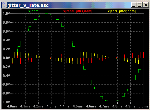

experts - more trouble than they're worth?

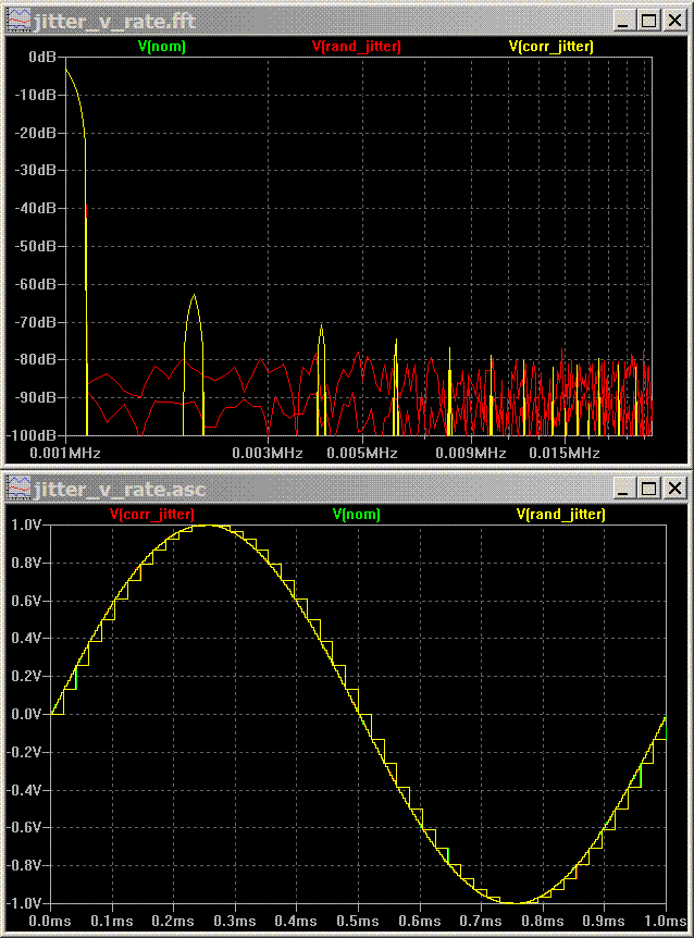

Jocko may be in good company but I don’t see how the attached sim can be reconciled with the expert’s opinion
I can't see how for a given jitter amplitude (nS, pk/rms) a multibit DAC's jitter sensitivity is increased by higher clock frequency
at the dac output dT*dV is the jitter induced error - correlate dT and dV all you want and you haven't increased its sensitivity to sample rate - perhaps its audible annoyance value can increase vs random jitter but sample rate falls out of the equation
please debug this sim if a certain “expert” wants to keep his credibility:
1KHz sine, sampled at 48KHz and 8x 48KHz, +/- 200 nS jitter
yellow correlated jitter spectrum is same for both sample rates, red random jitter is 12 dB lower for 8x rate
uncorrelated random jitter's spectrum is spread by higher sample rate and less falls in the audio band with higher sampling rate but I'm saying the worst case is that even if all of the jitter energy is concetrated in the audio band by complete signal correlation it does not increase with sample rate
I'm sure many clock multiplication schemes worsen jitter but that is not the multibit DAC's fault

now you saying don't confuse expertise with facts
face it Jocko your statement I quoted is simply wrong in the terms I explicitly laid out
now you're confounding the issue with anecdotal subjective evidence based on a complex system - really expert engineering practice
to know where to put your efforts in engineering requires understanding the separate sensitivities of the pieces of a complex system
increased jitter sensitivity with sample rate is not a property of a high resolution multibit dac
If you have references you think say otherwise I'm willing to learn

my 1st sim addresses that,
the yellow trace is from a sequence jittered samples of that is 200 nS "early" when the 1 KHz sine wave signal is positive and 200nS "late" when it is negative - any suggestions on how to get more correlated?
maybe this helps:
(increased jitter to 2 uS for visibility)
the sim plot in my previous post is 2 passes on top of each other, the yellow correlated dither traces are the same for 48 KHz and 8*48KHz sampling rate both with the same +/-200 nS bi-level jitter
I am claiming that when the multibit dac has enough resolution that it can resolve 8x more V steps when the clock is increased 8x then the jitter error (from the same jitter amplitude in nS) is constant in rms sum - ie a high resolution multibit dac's correlated jitter sensitivity is not changed by clock rate - random jitter is seen to go down in the sim as the increased clock rate spreads it beyond the audio frequency range
single bit dacs with delta-sigma modulation are a different story
maybe this helps:
