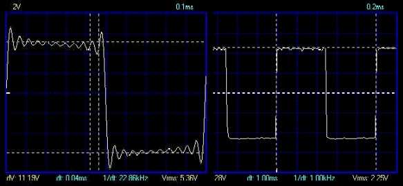

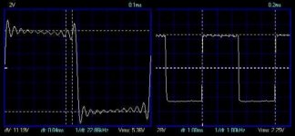

mmmmhhhh, just 2 pics measured at the analog output of my CD player (oversampled) and my DAC (non oversampling)
It seems to me the pre ringing clearly made it to the output ....
That is because your stimulus signal on the disc was a 'perfect' digital square, not? Like -100 +100 -100 +100 ...
Ask yourself: is such a signal allowed to exist in the 44.1kHz sampled space?
The answer to that is: no. Is it not a band-limited signal, and as such
it can not exist in a legal way in the sampled signal space. The only thing such a test does for you is to provide you with a readout of the oversampling filter's coefficients.
Same for all those impulse response tests: invalid stimulus.
Remember that a Shannon/Nyquest recording channel consists of anti-aliasing, ADC, DAC, reconstruction, and when testing one should test the whole chain, and not inject illegal signals before the DAC.
Unless one knows and understands the implications and the limitations of such a test.

Doede,
What remains is the result of imperfection in the filter. I won't claim you hear it or not, but the pre ringing shouldn't make it to the output when perfect implementation would be present.
Again, one of the many examples of concept versus implementation.

No Guido,
Sinc is a perfect reconstructor, but it too would ring when convolved with a non-limited impulse or square.
This is not about concept versus implementation, it is about understanding where the boundaries of the (digital) system under test are for any particular test.
Guido and dddac,
You had best listen to Werner - he really knows this stuff.
Werner accurately explained why the first waveform has "ringing". It is because a true square wave has frequency components up to infinity. When you limit the bandwidth of the sqaure wave, you will get exactly what is seen in the first picture. The "square" wave is now approximated by only the first few harmonics... 1 kHz, 3 kHz, 5, 7, 9, 11, 13, 15, 17, and 19. The result will not, and must not look like a square wave any longer, because it is not, by the fact that the higher frequencies are gone. What you see is not ringing caused by any filter, imperfect or otherwise. It is exactly what a band-limited square wave looks like.
The fact that the second screen looks like a square wave, means that this DAC has some serious problems. It is reproducing all sorts of ultrasonic garbage that should not be there. The square edges are a symptom of the incaccuracy of this DAC, not proof of accuracy.
Try this: build a 22 kHz high pass filter and connect the outputs of your DACs to it. It should pass virtually nothing. Try to guess what you'll see on your scope with your non-OS DAC with square wave input?
Mac,
forget about that square wave. Next thing that happens is that someone pops in and brings Gibbs with him. No need for that.
Point is that the impulse response of digital is not that of the DAC. It is that of the ADC/DAC and all related filters together. Only if then ringing persists is there any problem.
