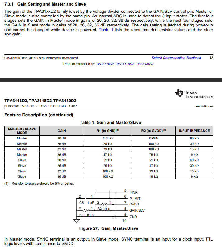

Power supply is weak at 70W input. Even the bench supply is a little weak (105W) to get 64W + 64W. However, if you were clipping due to supply dropout, that would sound horrible.
I wonder if you have the gain set high enough for the input signal you have. Here's a snip from the datasheet.

You may be right. Increasing the supply voltage would not increase the output because you are limited by the gain. I think there are some wrong component values on the board causing the gain to be wrong.
