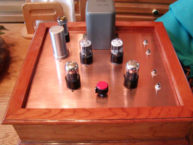

I used copper on my Aikido line stage because I ended up with a large piece from my fathers garage after he passed away. I wish that he could have seen the effort that I put into the project trying to make it half as good as he could have with his eyes closed.
It was my tribute to a great machinest and father. I never did get around to making a proper copper VC knob. Everytime I use it I think of him.

burnedfingers said:I used copper on my Aikido line stage because I ended up with a large piece from my fathers garage after he passed away. I wish that he could have seen the effort that I put into the project trying to make it half as good as he could have with his eyes closed.
Very nice amp, and a great way to remember your father. My dad was TV repairman back in the days of tubes. I have one of his Simpson 260s, which brings back fond memories every time I use it.
