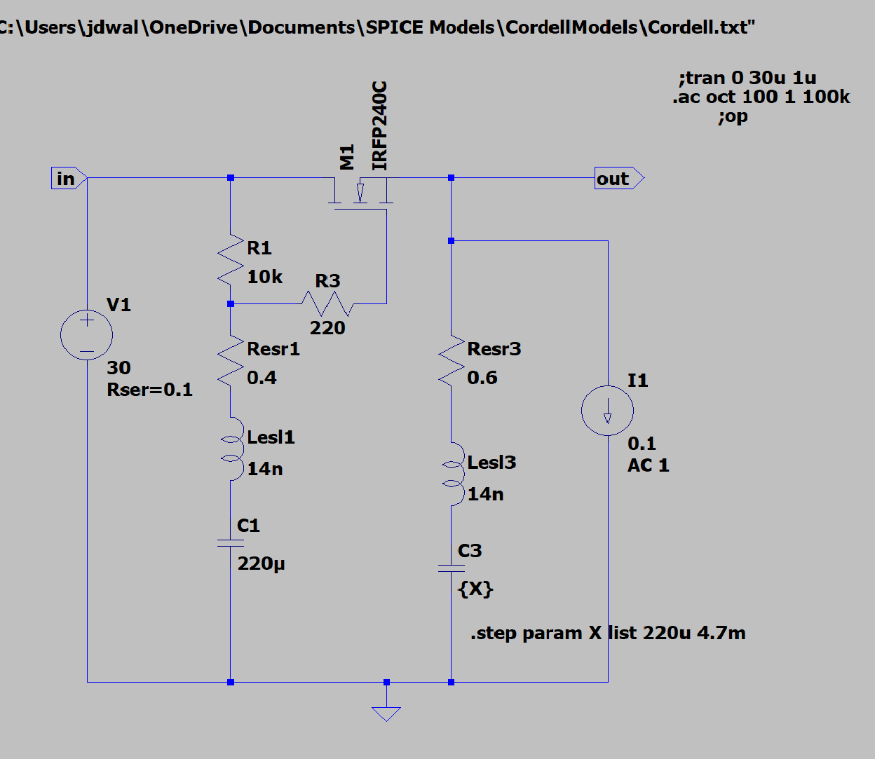

I decided to check actual circuit behavior and give reasonably correct explanation.
Every power supply has voltage change at its output under load and, for an audio signal, amplifier is dynamic load that pulls current from the PS, at the output signal frequency and load current. How much will PS voltage vary, depends on its internal impedance at the required frequency. This impedance is kept low, with help of the final output capacitor. Any voltage drop at the output capacitor is “filled up” from the first reservoir capacitor (and transformer + rectifier) through resistance between them. In case of simple CRC, there is usually 0.11 Ω.
Capacitance multiplier follows cleaned voltage after RC filter with smoothed ripple and noise, supplied to the base of regulating transistor (Darlington in this case). Output is at the emitter and it simply follows voltage present at the base. Every transistor needs, with increasing current, more voltage between base and emitter. So, if load increases, as base is at the steady voltage, emitter voltage must drop to get required Vbe increase for the larger output current. That’s why capacitance multiplier output voltage under load varies substantially, the same or even more than with the CRC supply and should have a large capacitor at the output.

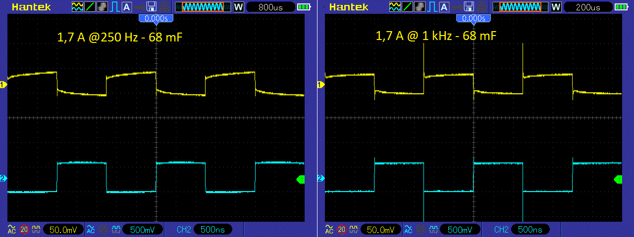

Nobody at diyAudio measures a damn thing when power supplies are in question. So, I made some PSRR and transient response measurements for the mentioned capacitance multiplier – Mark Johnson & Gtose design:
https://www.diyaudio.com/community/...sy-capacitance-multiplier.297921/post-6031533

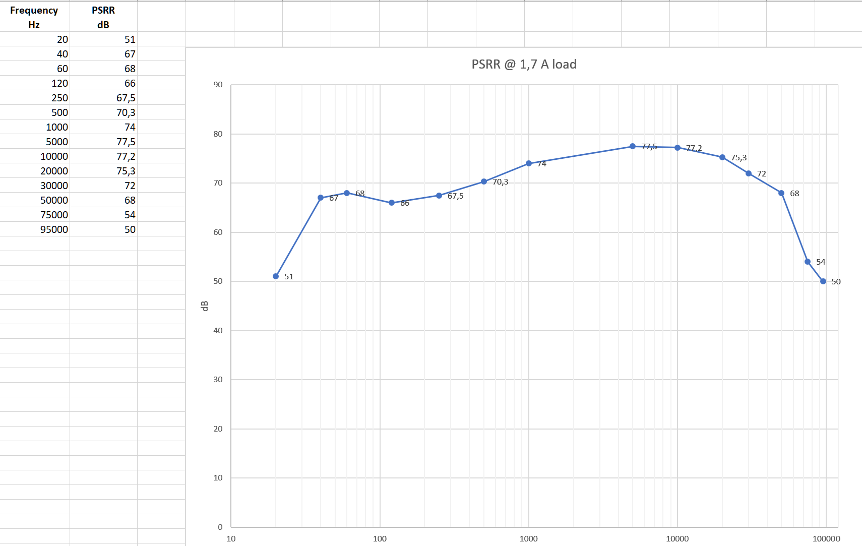

First point worth to mention: PSRR changes a lot with load current! Measured at 120 Hz with 5 mF capacitor:
Another point: large output capacitor (68 mF) increases PSRR at all load currents by 6 – 8 dB.
Measurement from 20 Hz to 95 kHz at 1.7 A load, for the Cap Mx assembled using breadboard, so actual circuit could be several dB better, but not much.
Note: PSRR is not a level below some reference, rather PSRR is ratio between two values and shouldn’t be expressed as a negative number. Yes, usual representation in various datasheets with PSRR as some -XX dB number is wrong!

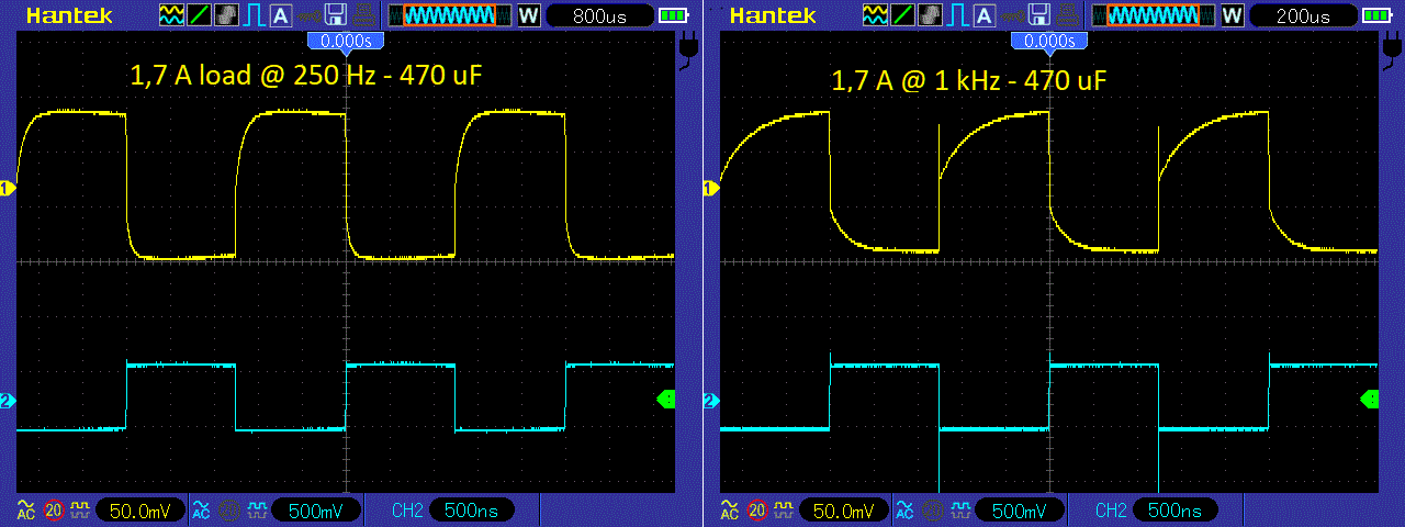

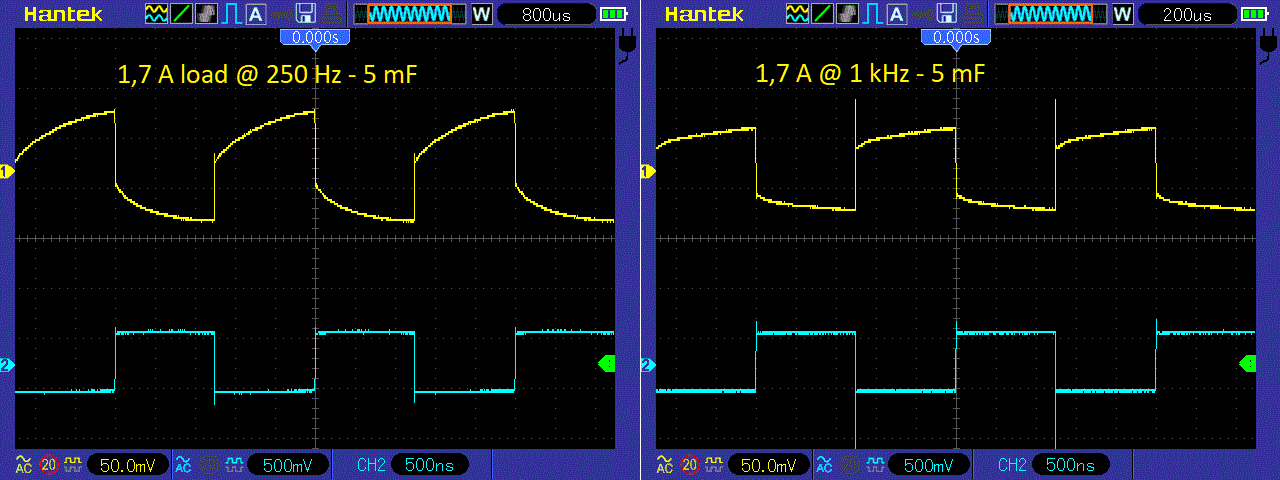

Transient response was checked with 1.7 A square wave load at 250 Hz and 1000 Hz, with 470 uF as base and then with 5 mF and 68 mF output capacitors. We can see that, with the small output capacitor, output voltage drops immediately, while with larger output capacitor voltage drop is smaller and gradual. At higher frequency, where internal capacitor ESR is lower and load time is shorter, drop is even smaller. Yellow trace is output voltage and blue is voltage drop across the 0.33 Ω resistor at the active load.
We can conclude that, as output capacitance or frequency is increased, voltage drop becomes smaller. It is 130 mV with small output capacitor and 40 mV with largest.
In case of power amplifier, 10 - 15 mF is not an optimal value at the output of capacitance multiplier circuit. We should use 33 – 47 mF, as with the standard CRC PS.
- 0.2 A – 94 dB
- 0.9 A – 72 dB
- 1.7 A – 66 dB
- 2.5 A – 59 dB
- 3.5 A – 41 dB

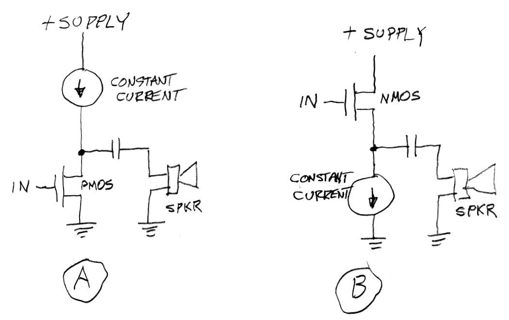

Not all amplifiers may be considered a dynamic load to the power supply. Most (all?) Class-A amps will simply pull a constant current from the power supply. The energy storage to cover dynamic spikes is not all that important for such amps. I have tested with with a scope hooked to the output of a Smooth-Like-Buttah (SLB) cap multiplier feeding a Class-A amp. I couldn't see much much of the audio signal on the SLB output, even though there was no extra storage capacitors in place.Every power supply has voltage change at its output under load and, for an audio signal, amplifier is dynamic load that pulls current from the PS, at the output signal frequency and load current.

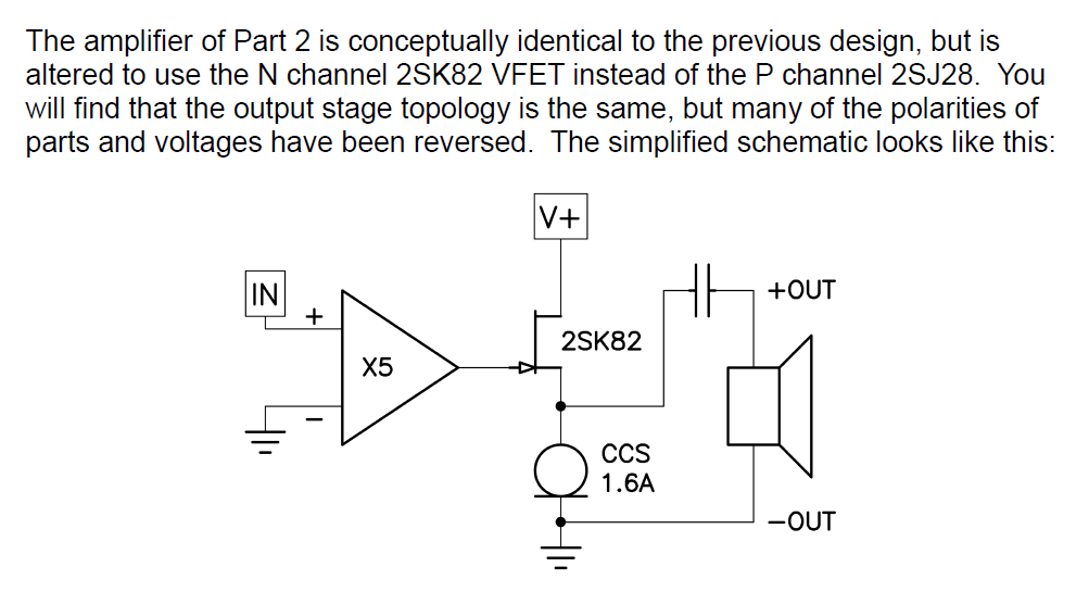

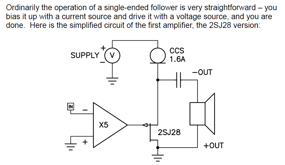

On the contrary, only some A class amps will pull constant current while playing music. In example, single ended with CCS, pulls constant current all the time. Most will have dynamic current change equal to the output current. Especially DEF amplifiers like SissySIT and LuDEF are wild beasts having about 2.6 times greater current change at one rail, due output semiconductors transconductance difference. SisySIT at the negative rail, LuDEF at the positive rail.
This isn't really true.
Figure 1 below shows two single ended amplifiers, each one has a constant current source. CCS-single_ended amplifier "A" on the left, pulls constant current from its power supply. CCS-single_ended amplifier "B" on the right, draws a non-constant current from its power supply. Supply current equals current through the loudspeaker (I = Vout/8ohms) plus current through the CCS. Since the amplifier output voltage Vout varies with time [hey that's music!], the total supply current varies with time.

I see an inconsistency in the results (I am generally no great fan of cap-mults, but that's another debate).
In this pic for example, the left waveform looks like it should:
The waveform on the right has a positive spike at the positive edge, which in itself could be normal if the layout or the capacitor is imperfect (series inductance f.e.), but since the cap and layout are the same (in principle), the left one should display the same effect, just shorter.

Observed inconsistency is caused by several factors:
Signal averaging (16 averages) was used to exclude small variations as measurement setup is not professional one, so depends on which 16 averages was caught. There are some small peaks visible at 250 Hz measurements with 5 mF and 68 mF.
Longer time base + averaging at 250 Hz hides fast peaks, that were there if averaging is switched off.
Shorter time base at 1 kHz helps to catch and display those fast signal peaks.

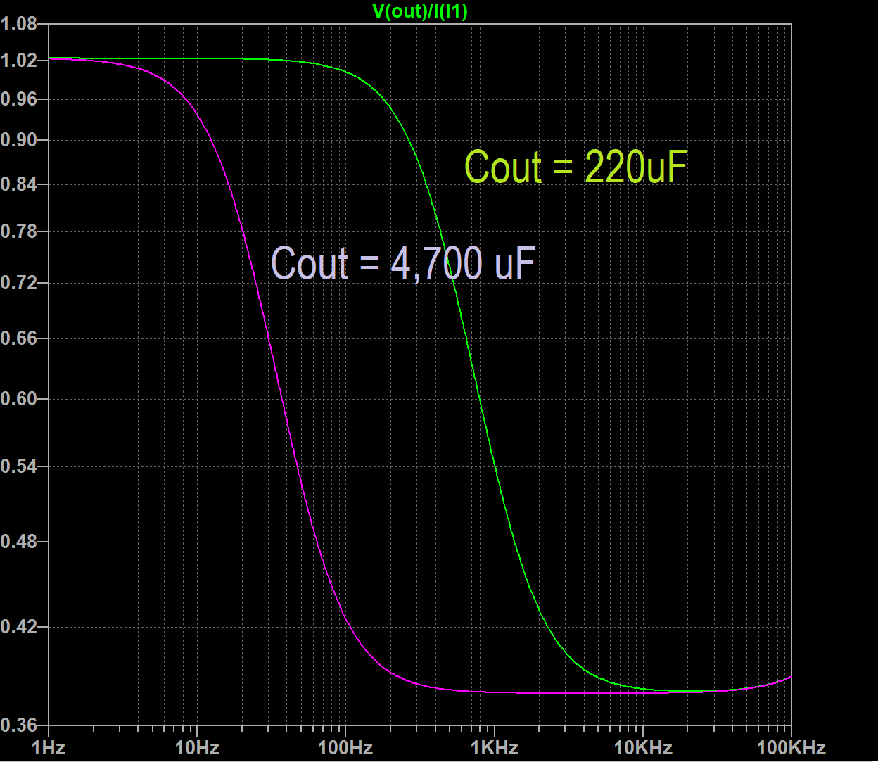

Except that cap multipliers are not regulators. Their output fluctuates with current draw; a true regulator is rock-stable, less than a mV drop with an amp current delta (yes, that's less than 1mOhms Zout).Jan-
You are absolutely correct as to the availability of ultra low noise, high PSRR regulators (LT3042 etc) but that type of performance (<1uV RMS) is certainly not needed in audio applications. The capacitance multipliers being discussed can certainly be used be used as pre-regulators in applications requiring such low noise levels as they are very effective at low frequencies.
Hal
You can somewhat make up for the cap mux high Zout with a monstruous cap. If you like that kind of stopgaps.
