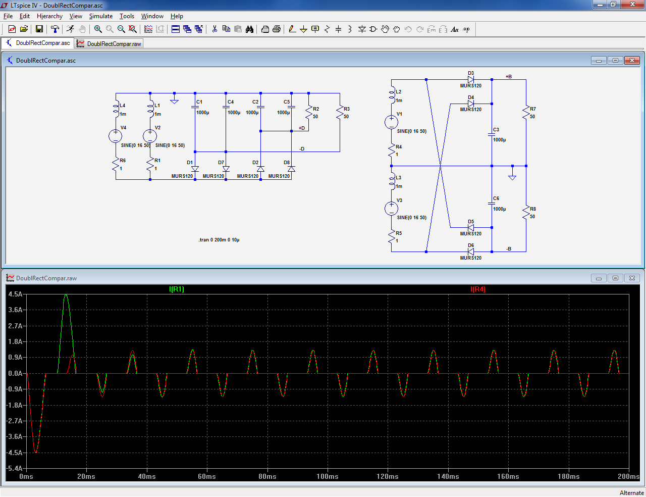

You now admit doubler operation is infact only half wave rectification with all that implies on adding capacitance across the load to compensate ...thus reactive current has increased over the 4 diode version (with equal ripple on the loads ). I'm sorry XFMER utilization is not the same or better for half wave rectification. I don't call it a minor difference on some real designs esp. with small transformers. You can see for yourself on your model if you care to show the output ripple voltages as magnitudes, not simply dismiss it as mains or 2x mains frequencies.

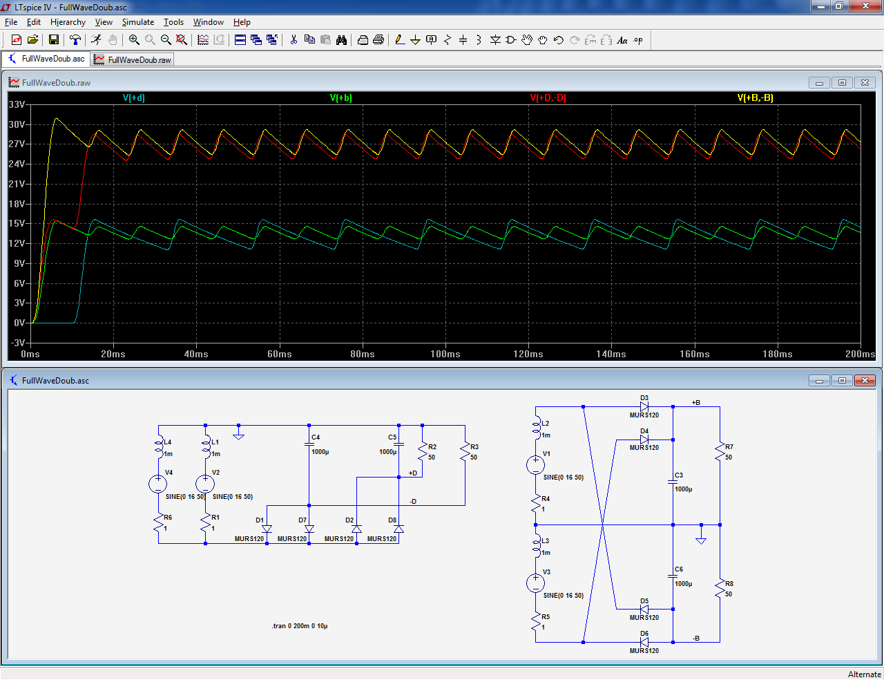

The supply in Question is a dual with a central ground. On your simulation you modified the circuit.. The waveform you showed was a single balanced system operating as full wave which was/is very deceiving, not accurate at all.
That's the problem with simulating designs, at some point you have to build it. That's when the "minor" problems smack you upside the head. Little dual regulated linear supplies are hidden with many gotchas. Starting with this doubler topology youll either have live with higher ripple and more 3T regulator headroom / heatsinks or buying bigger caps, in either case the XFMR will running at hotter VA's.
You now admit doubler operation is infact only half wave rectification....
I am not admitting it now: if you cared to read the previous posts, I mentionned it from the very beginning:
The differences between a FW doubler and a FW rectifier using a winding of twice the voltage is very subtle indeed, and could be missed in a first analysis, but they do exist: in a FW rectifier, two sets of diodes replenish a single filter capacitor twice per cycle, whereas in a (so-called) FW voltage doubler, two times one diode replenish two caps once per cycle, and the cap voltages are later added.
The result looks superficially similar, but it isn't: adding two half-wave rectifiers isn't equivalent to a true full wave rectifier.
The ripple seen by each half-wave cap is somewhat higher,
Here are the individual V+ outputs for each case, and also the voltages sum:
attachment.php

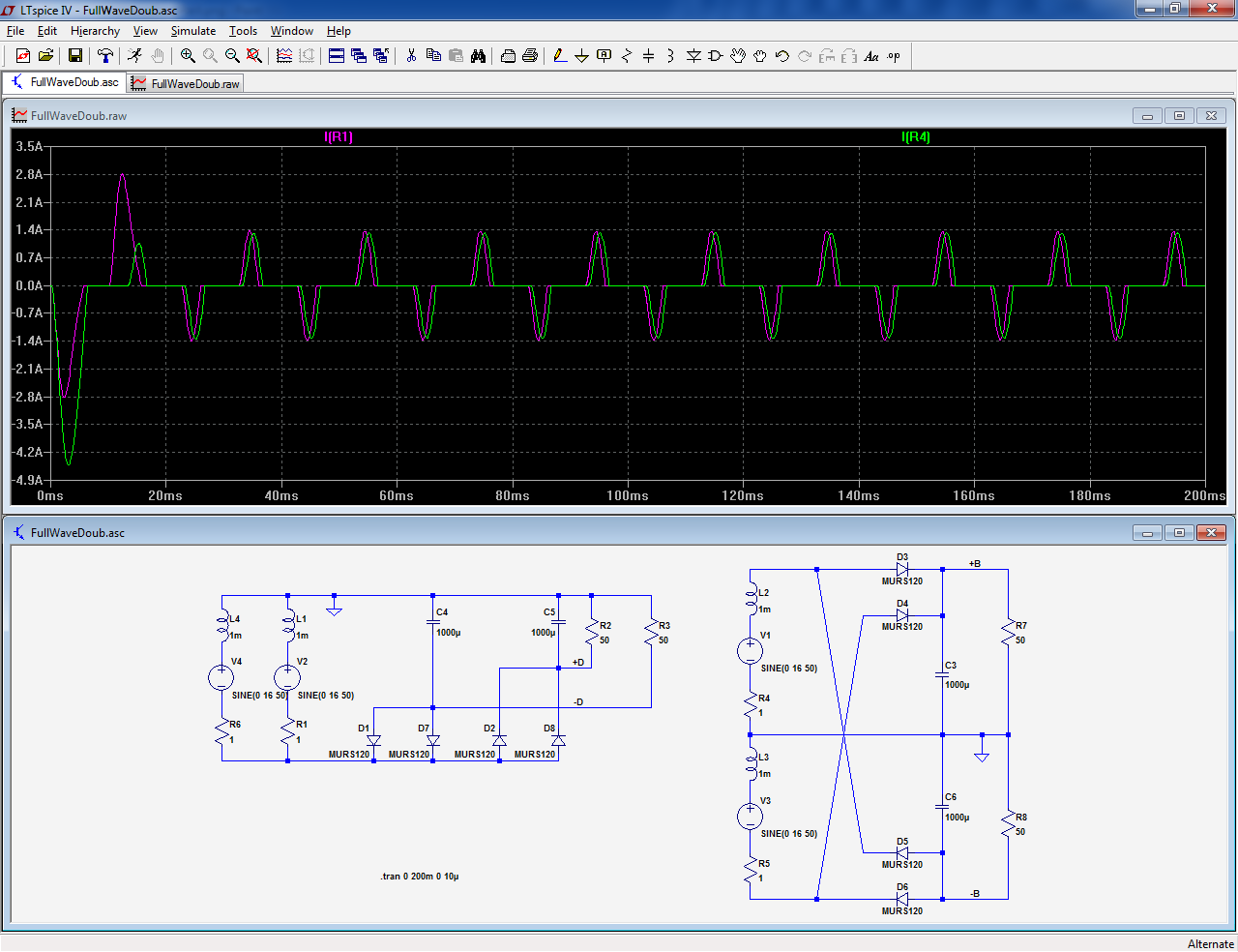

For this situation, the transformers currents are comparable:
attachment.php

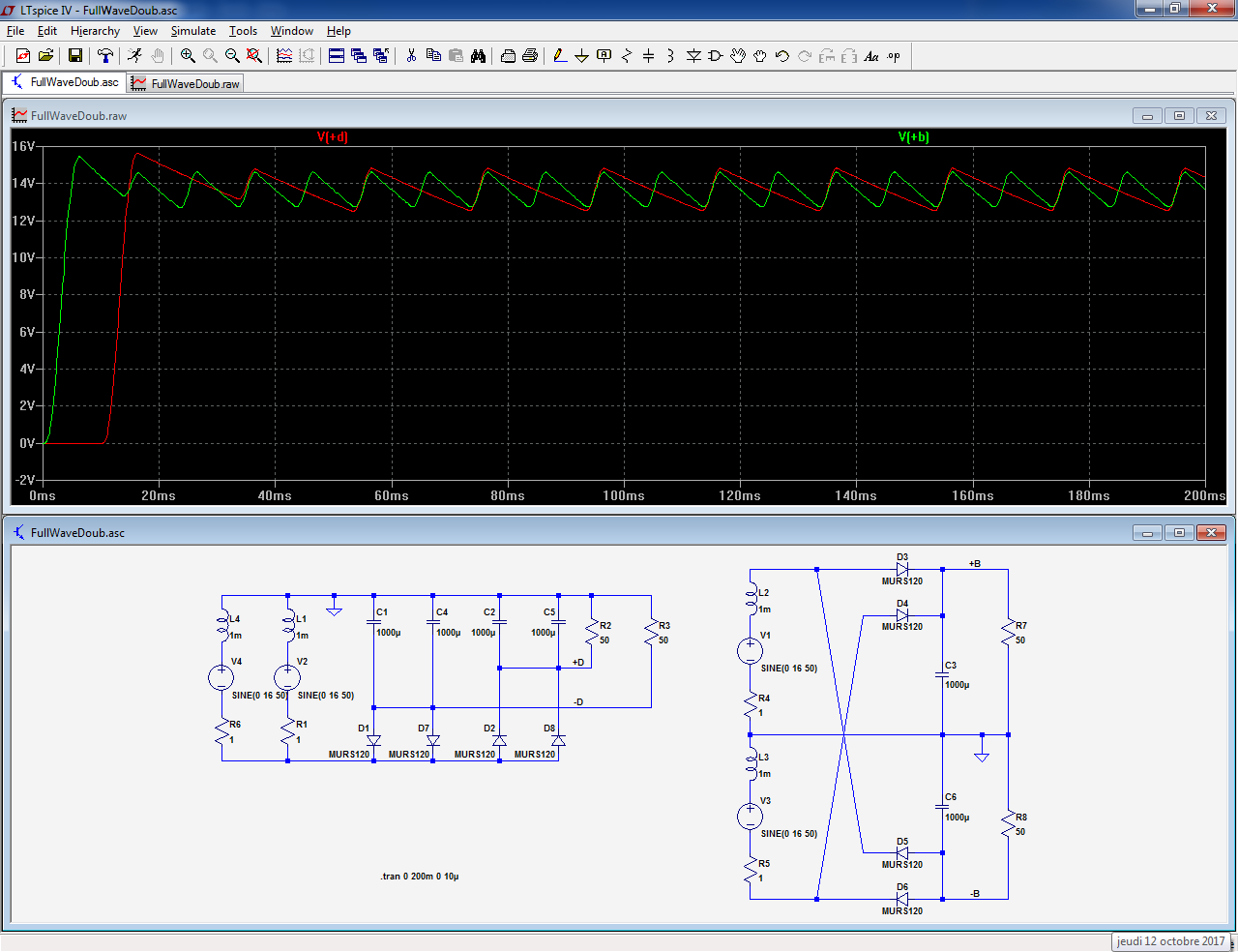

We can increase the filter caps to compensate for the higher ripple:
attachment.php
This does practically not change the peak currents compared to the previous case (it looks counter-intuitive), because the average output current remains practically identical, as is the diodes conduction angle.
What about the individual ripple voltages? They are now practically identical:
attachment.php
Thus, there is a penalty to be paid (twice the C*V product), but it remains relatively acceptable.

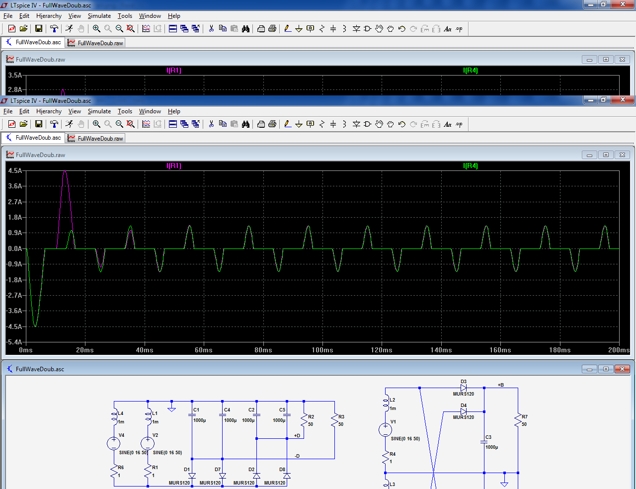

Now I still have issues with your last sim on the actual circuit.Strangely you added caps to the full wave side correcting the current angle, when we both know it should of been added to the half wave side. right?
There must be some misunderstanding, because I added the capacitors to the half-wave side (I think), where the voltages have a D suffix:
I repost the same picture here, to eliminate possible confusions:
attachment.php
C4 and C5 have been added to compensate for the weakness of the doubler; without them, the comparison is completely fair, ie. identical circuits elements are rearranged in a different manner.
Note that the current angle will only have a minuscule effect on the power factor: most of it stems from the high peak to average ratio, inherent to this type of supply, not the I-V phase shift.
Realizing the reactive current is C*dV/dt looking at the ripple voltage I fully agree 100% on this but your sim results and other statements don't support this view.
I do not see where.
The peak current remains ~the same, because the positive slope of the ripple is halved, but the capacitance is doubled.
The area under the peak must remain the same, because the average current is identical.
Note that in all of the cases, the current is measured on one winding, even though the windings are paralleled in the doubler's case. That's to respect the fairness condition:
The primary winding will always see both windings in front of him, be they series or paralleled.

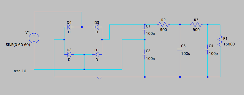

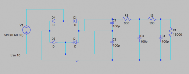

Hello! An old thread but a good one, I figure it's a good place to ask.
I need to get a -100V bias from a 60V power transformer winding and noodling around on LT (which I am very new at) I started playing with this circuit.
I've never seen a bridge used to double before. Is there any reason it shouldn't be used to feed the bottom of a 470K grid resistor? As is, it has .1mA ripple at output.
It will work, but D3 and D4 are purely decorative: they are permanently reverse-biased, and you could safely remove them.
D1 and D2 do the active work, and it boils down to a Latour (or Delon) doubler.
It can certainly work for the intended purpose
