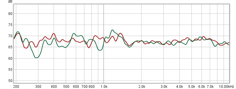

P.S. just measured my B&W's and the mid is at 35.5" from the floor, also my Ohm 2's are a different bird (Omnis with a vertical cone aiming down) They have the top of the wood base at 2' above the floor and the top of the metal canister 6" above that. I should measure the B&W's where they are, and then try again with a 10" riser and see what REW shows.
So, below is a comparison using REW of my B&W DM640 on the floor 1/24th octave smoothing. (Midrange at 35.5" above the floor (Green) and with a 12" riser (Red) Microphone was at 45" above floor 8' away which is the main listening position. Speaker is near the front-right corner of the room, the room has a 9' ceiling, nearest wall to the microphone is 6' away to the right, the wall to the left is 8' away.
Looks to me like I should be getting some 12" risers permanently, since the red trace has a 5db swing (flatter) between 200 and 2000 hz vs a 10 db swing for the green trace. I'm relatively new at generating and interpreting graphs, but it seems that there is less room interaction to the midrange with the midrange 12" higher (at the same height as my ears) which bears the OP's hypothesis.
Comments? Sixto. - still learning how to attach images inline.
