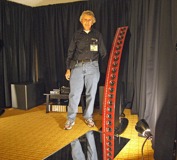

Why is floor bounce considered only a bass issue?
How does a CBT array do that? Would a normal array suffer floor bounce or is it mostly a point source problem?
It has to with the fact that it uses the floor as a mirror, doubling its size.
attachment.php
It's related to the directivity. So with CBT there are no reflections above Schroeder from the floor. Obviously there will still be vertical modal behaviour.

Not sure what you mean. But you're referring to a speaker driver placed close to the floor, that alone doesn't avoid floor reflections. Basically makes them arrive closer to the direct signal.
perhaps it sounds counterintuitive but effectively it does, just point the speaker up
