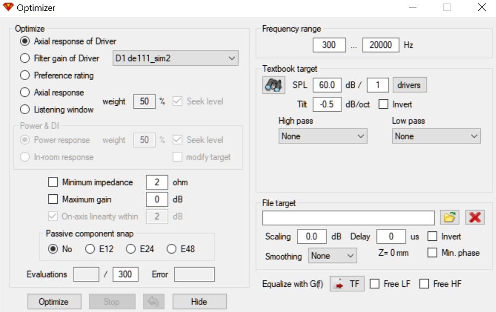

@SpeakerBob may have answered a question I had about using VituixCAD to flatten drivers using the transfer function block, G(f). I tried to use gated in room and ground plane measurements. Those both failed. Then I tried outdoor ground plane measurements. Those failed too. It didn't work right until I put the woofer 12 feet up (3.65 meters) and then merged the near field woofer response before using the Optimizer to flatten on axis. They sounded great after that.
I was hoping that wasn't necessary because it isn't easy for everyone to do that. But maybe matching to a room curve solves the problem.
