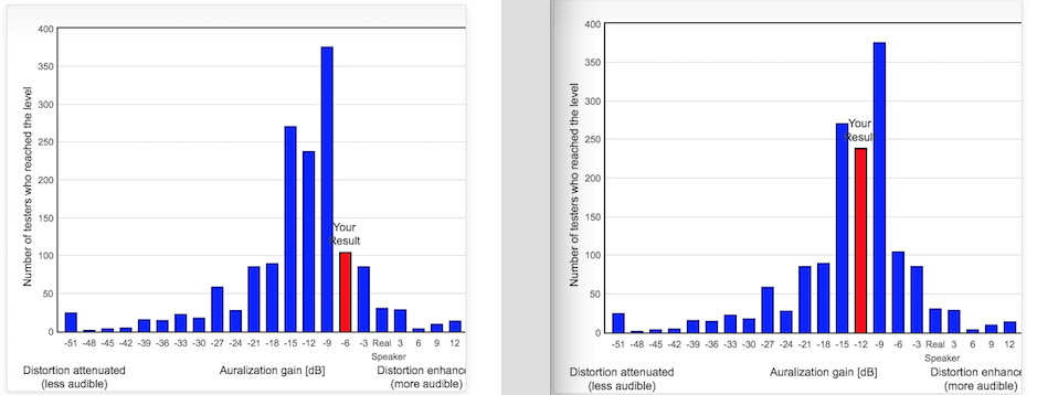

Try the Klippel listening test and see if you still have the same understanding of what level and type of distortion is clearly audible to you and others, (8003 paticipants as of 1/7/21, last time I checked).
How did you do with it? I got -39 dB, could probably get to -43 with practice. I used the test tones since they would probably be the easiest. Fascinating that a fair number of respondents got into the minus 50~60 dB range, impressive. So in real world terms, I should not be able to hear any distortion in a Purifi 6.5 midrange where the noise levels are generally at -50 or better, but for the Faital, where that peak is only 30 dB below the signal for H2 and 40 dB for H3 I should just be able to perceive the driver as "flawed", provided the right program content and I'm paying attention and again, acknowledging that these are fairly high listening levels. Note that my rooms are fairly large so while one would not sit 3 feet in front of these drivers at 104 dB, they could easily be called upon to play at these levels during high volume passages when sitting 12 feet away in an 18x24 room. But that's a useless debate- someone can always claim "more". My point is still that the Faital does not measure better than a few other drivers out there, including from what I can find, ones from Purifi, SB, Wavecor, and Seas, among others, although some are significantly more expensive than the Faital and some are not, and the distortion could be detected. Of course measurements aren't everything, just surprised the distortion isn't leading people to be more superlative in their comments about other drivers.
Using the "full range speaker" "two-tone 70Hz 800Hz" Klippel listening test my range has been around -33, similar to most respondents, one time as low as -51, today somewhere between the two.
As it is for most, my distortion audibility threshold is much lower using tones rather than music.
And distortion in music can easily mask speaker distortion.
Today, using "Music T. Chapman-Bl only", listening to speakers with hearing aids on, was at -6dB (not good..) took them off and reached -12, about the middle of the pack now, three years ago was -18.
Fairly certain that the progressive loss of high frequency hearing sensitivity has also raised my distortion threshold..
At any rate, it is interesting to hear what the different types of speaker distortion sound like in isolation, and what one's individual perception level of those distortions are with different sources.
