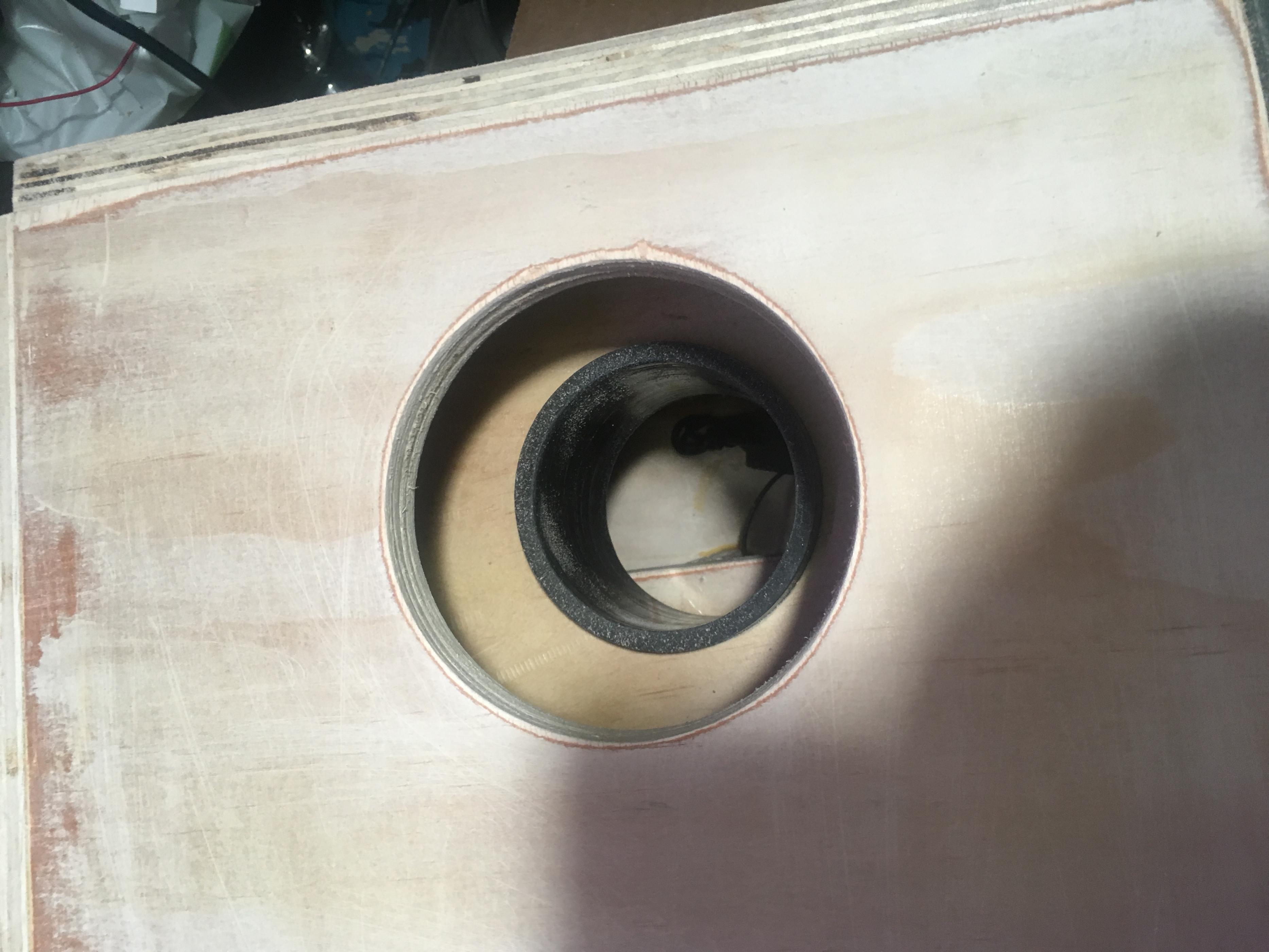

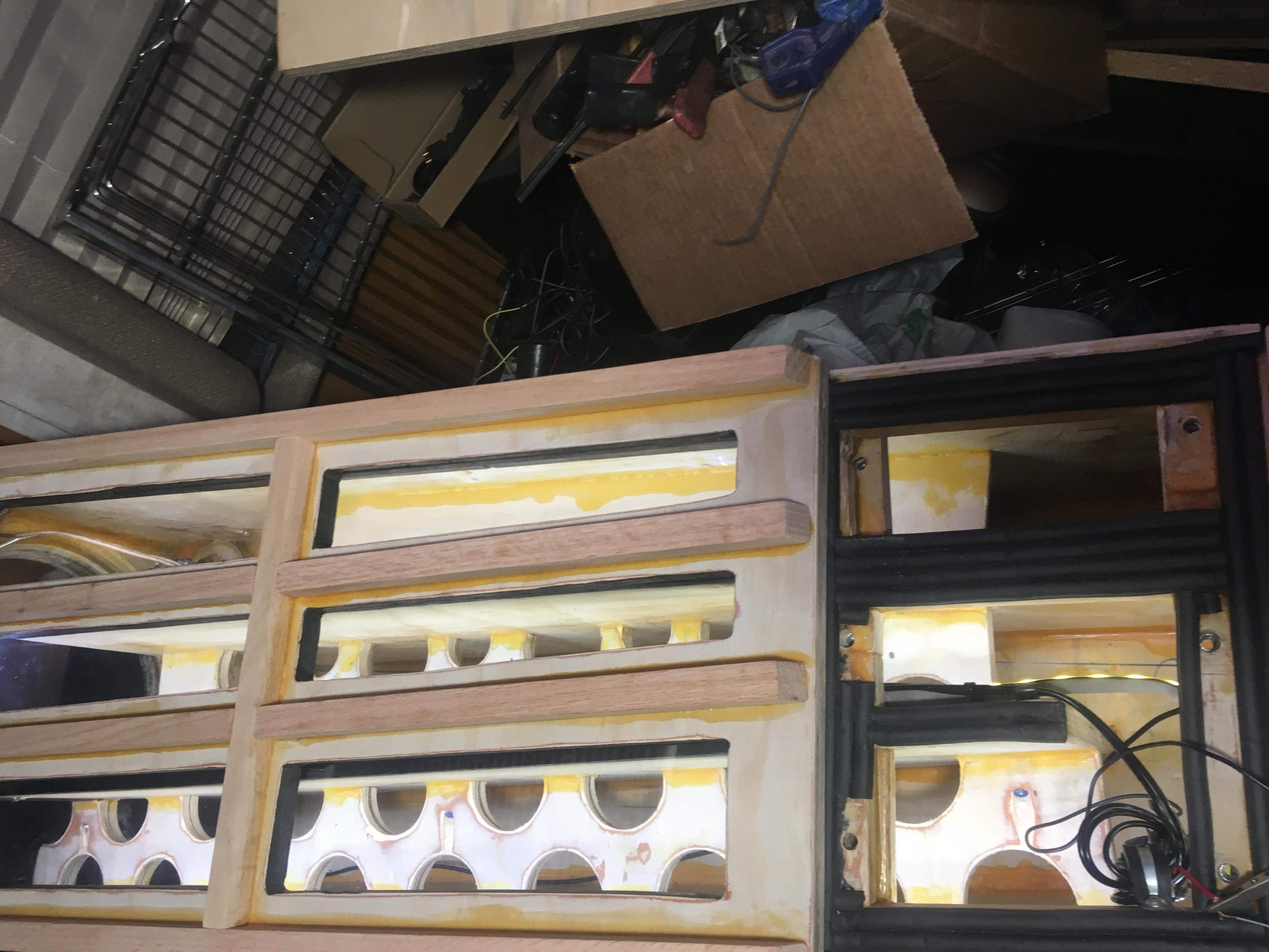

Not sure? But im going to start with thus OD TL... made to drag a mic and pressure sensor(?)around inside by a magnet on the other side of the lexan as shown

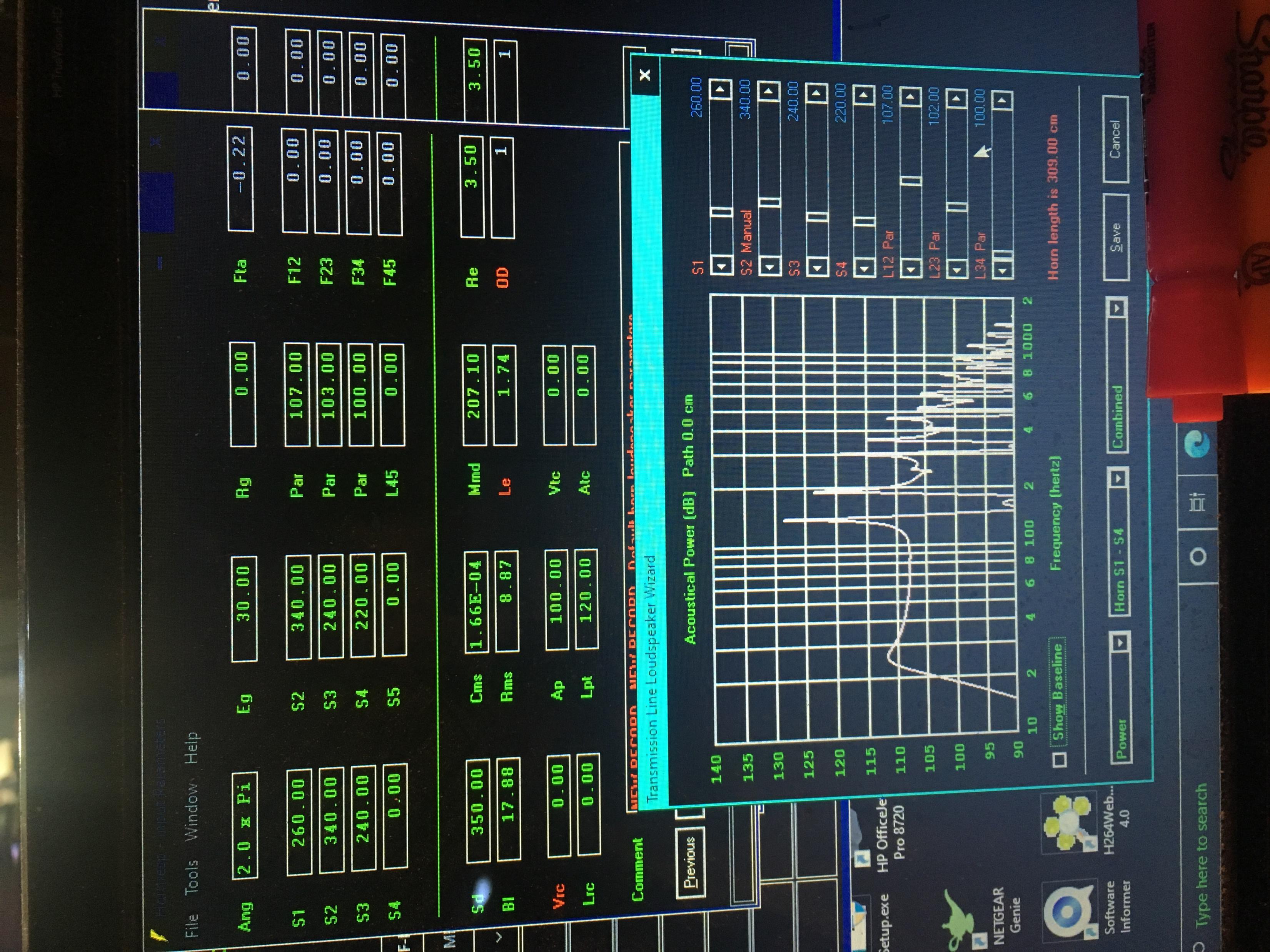

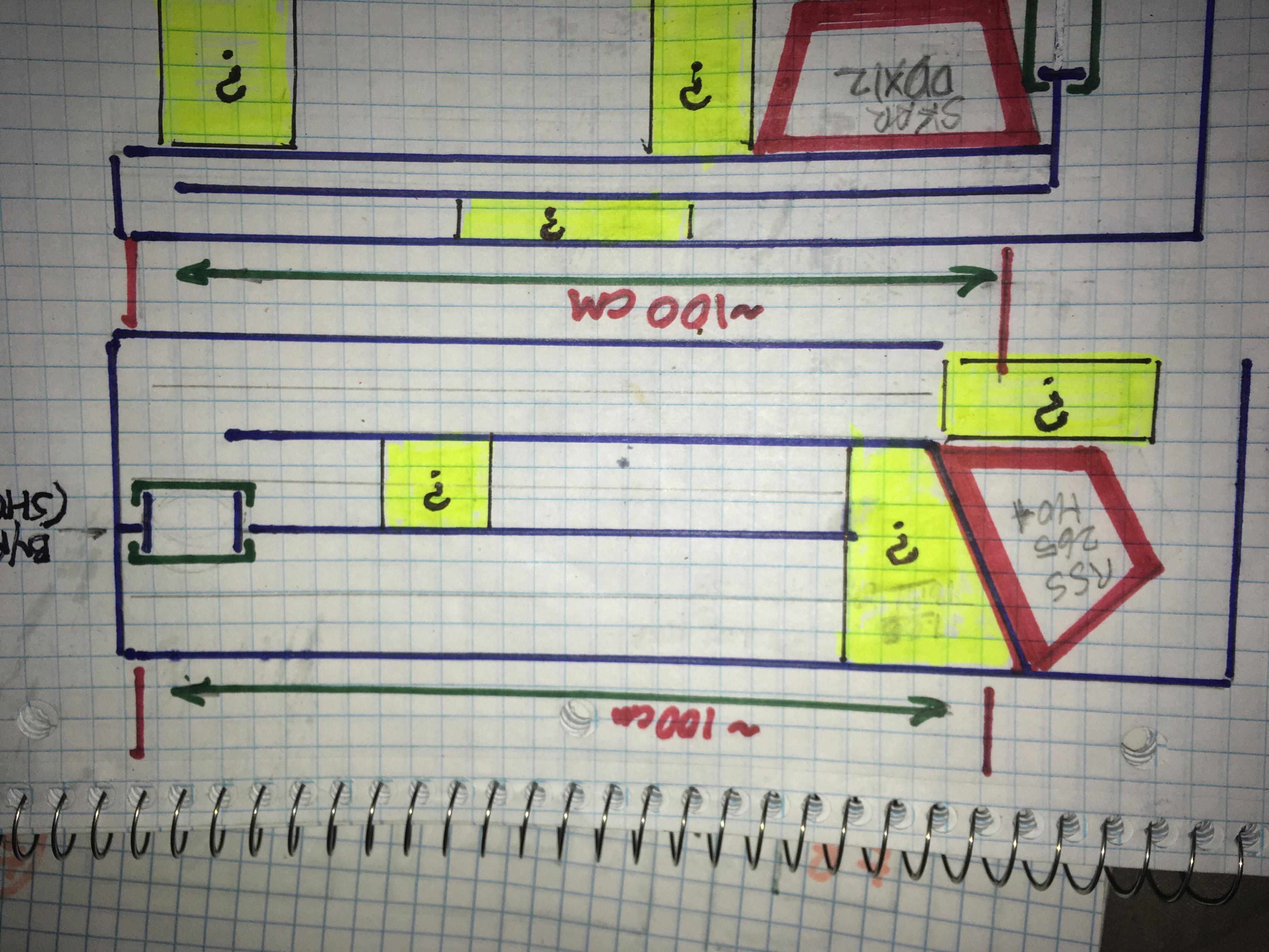

Heres what im using to ‘screw up’ an already established offset pipe that should represent itself as simmed, or very close to what will be the standard of reference for things to be once changed(see the ‘bypass’ in the first and middle segments of the pipe (not the one beside it, (above in thumbnail it) thats next on the menu of changes to observe..
This 3” sched40 with a threaded bung and cap wimhich is easily accessd and open/ shut fully or (later) given layered discs you might see in a spark arrestor type of muffler ‘suppertrapp’ formerly in ‘ktm’ speak to me otherwise..
But also, this removes the stub, creates a stepped taper as two segment pipeoff the driver-at end instead.. and much more to come if i find things worth ‘studying, learning real, no more cheating by reading and borrowing the experience of others(many of which are here in this place and the hours and hours ive spent reading your typed wordsarchives and past threads and links and pictures(thank you for that btw!!)
So, im assuming (after a confirmation of the build to sim in REW nd with the datsv3 ) that im gonna go searching for landmarks inside this. And by a yet to be determined?(?) pressure transducer (?) or possibly a cheap manometer from amazons offbrand electrics section and the UMM6 in REw, with individual tones(sine wave or ?) im Gonna locate some things? And by opening the bypass they might be gone, relocated, list or gained dB or a pressure null or peak??? But, what and where might not be exactly as im assming? And kibd of why im asking 🙂 what could be ? What other things could i create here while still not sealed up and glue cured might i wanna make possible in this lab rat?

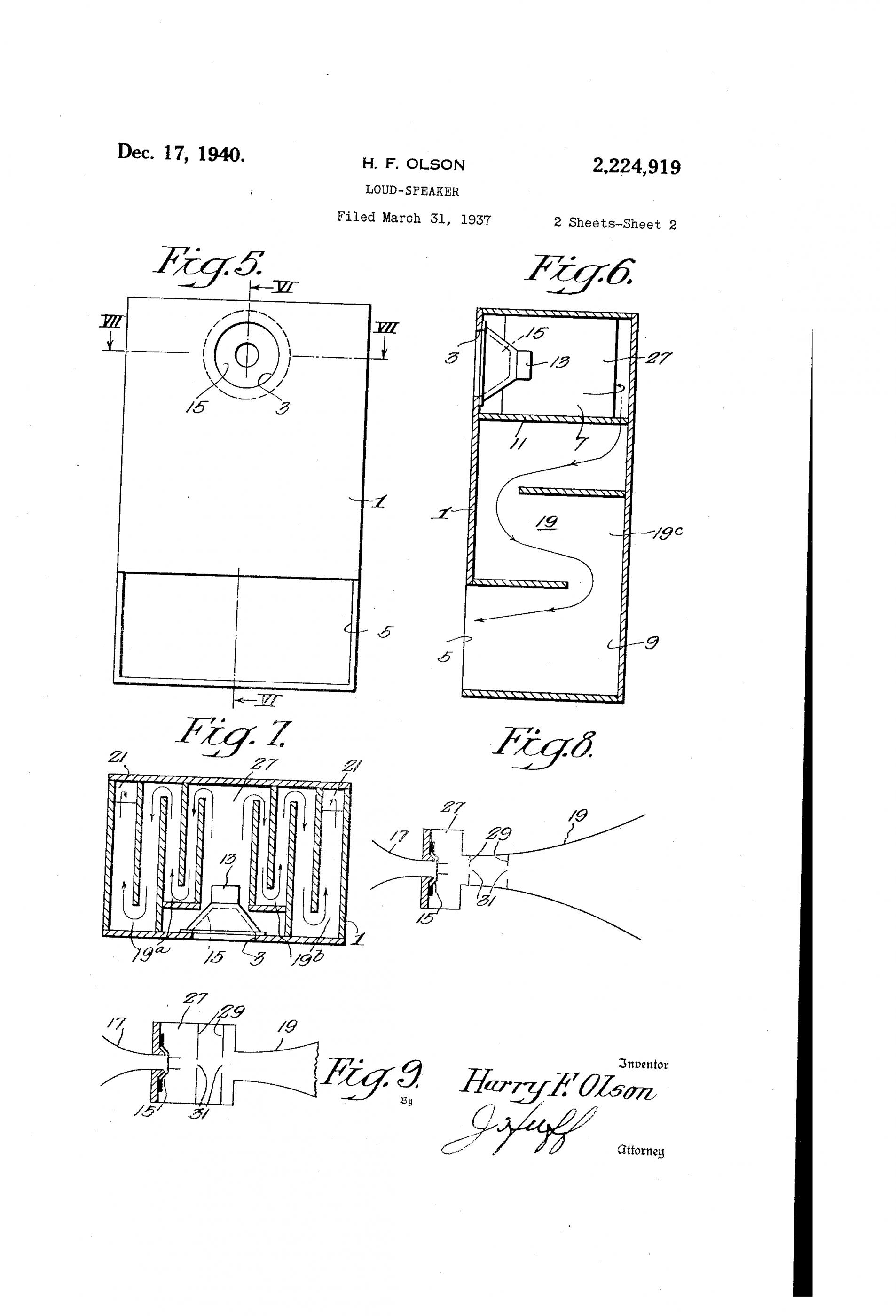

On a side note: looking for detailed pics of Harry Olsens compound horns, specifically his mid 30s patent horn with ‘stubs or constrictions noted in the path strategically(check out 29 and 31 in the drawing)
