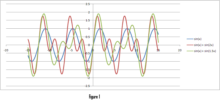

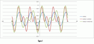

ScottTracy said:
If however, you add SIN(1.5*w*t) to it, the output will not have the same period. See fig.1. I guess you could call it a boundary condition in the time domain that when the input signal is at 0, the output should be too.
Not necessarily so, as there will always be time delays, furthermore, there might be linear distortion . Your picture is perfectly correct, but your 1.5wt is effectively a different frequency, that cannot be generated by distortion processes.
It may be that we should start asking questions of the measurement methods at hand, but I personally don't think so - it is more of developing an understanding of the interpretation of our modern measurements, like how do we interpret the distortion spectrum with respect to perceived sound quality.
In terms of theoretical processes, there is really nothing new under the sun - IMHO.
