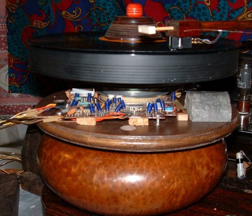

Hi guys I know this isnt a class piece of gear but I think the bearing
I made for my home built TT may be of use and its dead simple-
When you make the spindle support bush it will probably have the drill
angle left at the bottom of the tube, 118 degree vee for a normal twist drill. Drop a suitable ball bearing into the bush about 1/4 or 5/16 depending on the spindle size .Drill the end of the spindle so that a
1/8 or 3/16 ball bearing fits in to just over half its depth and peen it in with a dot punch. eh voila hardened steel point contact. fill with oil to taste.
