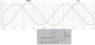

This isn't quite right. In the case of a driver, when voltage, current and acoustic output all align, the signals are in phase. It is possible to cause a delay of all three and they would still be in phase. It is when one or more of the three doesn't align with the others that there is a phase error.
Attached is a very simple circuit showing the relationship between Voltage and current across an inductor at 1KHz. These signals are not in phase.
