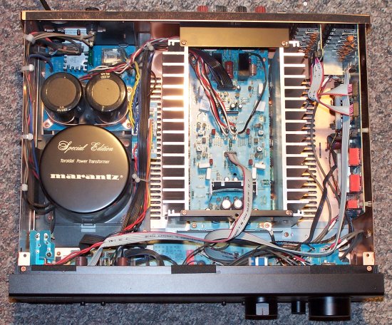

A class A amp is a different story. The heatsink needs to be properly sized and the transistors mounted with electrical insulation and thermal paste. My Marantz PM80SE is a good example, a large part of space inside this amp is used for the heatsinks. In class A mode (it can also be switched into AB mode) it needs a lot of free space around it and especially above it to ventilate.
