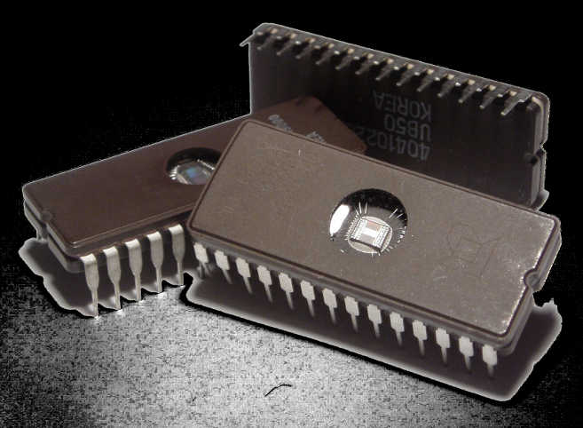

The purpose of the window was to allow erasure of the memory using light, UV I believe.Years ago, my co-workers had a strange problem with their prototype. It turned out that they had not covered the window on an EPROM, which was photo sensitive.

That is correct.Yes, but after erasure, a special sticker is placed over the window to block light.
