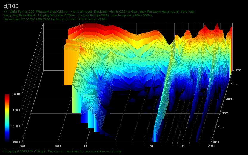

This is a waterfall of a pressure response at a mic location. I don't want to sound pedantic but I think it makes a difference. It would be different at another location. Some breakup region issues can remain unexposed.a driver without seeing its waterfall chart
celef, as a result of issues like this the drivers could sound more similar when suitably band limited.

I think a lot of people put more weight on decay/waterfall measurements than is actually audible. Practical musical instruments have extremely long decays by comparison, so some mild ringing from driver itself is unnoticeable. It's easy to fall into the trap of putting more weight on types of measurements which seem like they are easy to subjectively evaluate (frequency response, decay) and ignore the ones that are more difficult to describe in words (harmonic distortion, intermodulation distortion).

Breakup not only has time domain consequences but also spatial effects. The cone or dome will invariably stop moving pistonic and as a result the polar pattern will change. Together with that: ringing comes with level increases that will be audible. EQ-ing brings down level but the resulting power response also has changed.
That is true as long as all frequencies decay at the same rate, unlike in this example:
