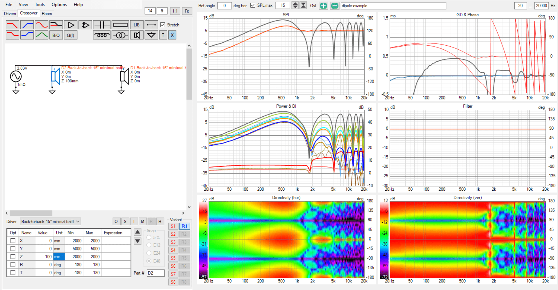

Ok, making double dipole like so increases SPL without affecting bandwidth of the driver. In other words the usable bandwidth upper limit stays the same while sensitivity increases. If drivers were on same baffle the baffle size would increase which brings down the dipole null/diffraction, the usable bandwidth. Trick here is to keep distance of the two as small as possible in order not to drop the usable bandwidth again.

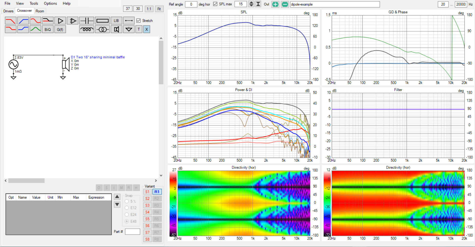

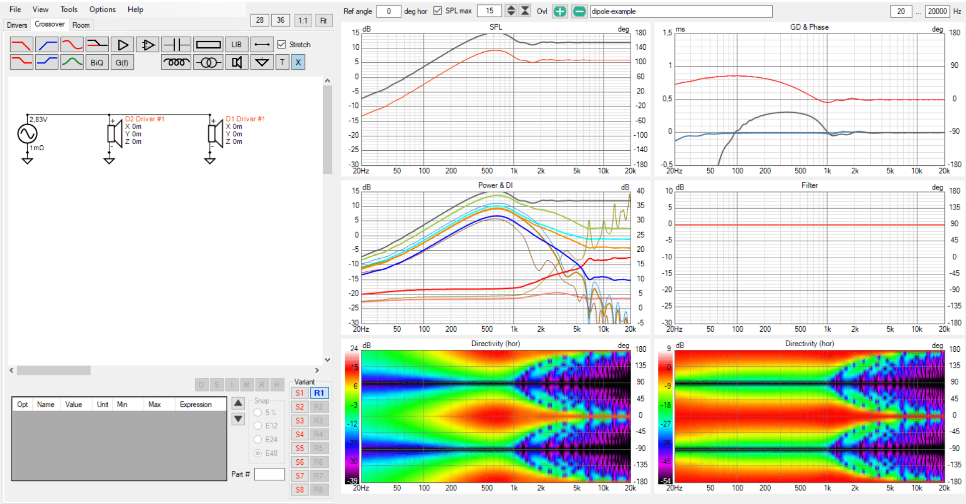

This is ideal 15" driver on minimal baffle

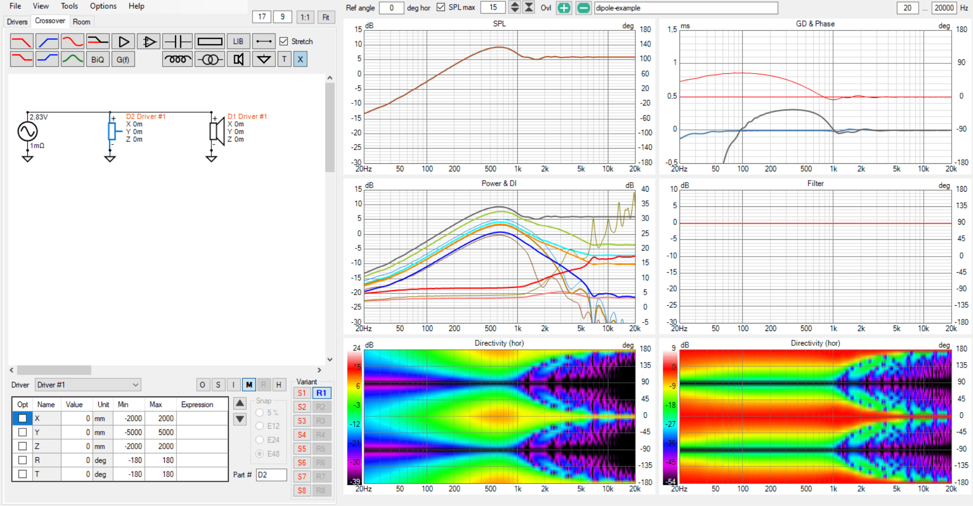

And here is two coincident (physically impossible) to demonstrate the sensitivity boost of 6db

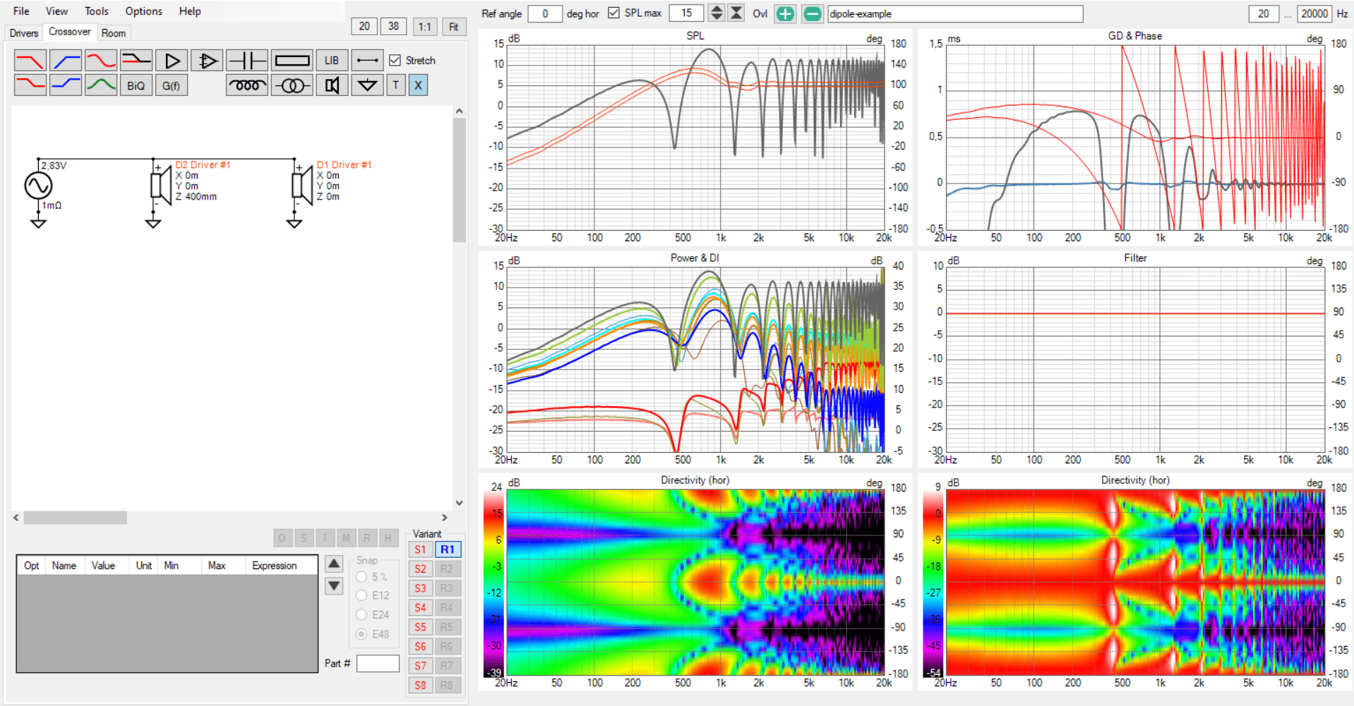

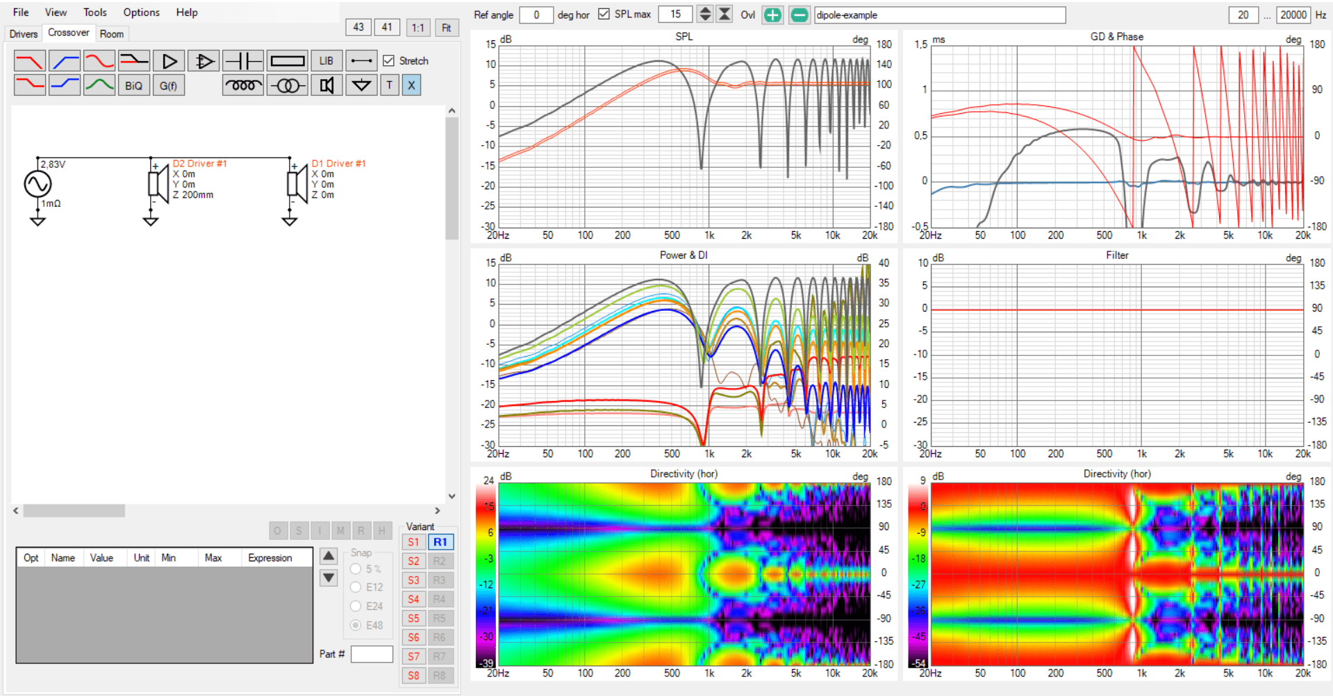

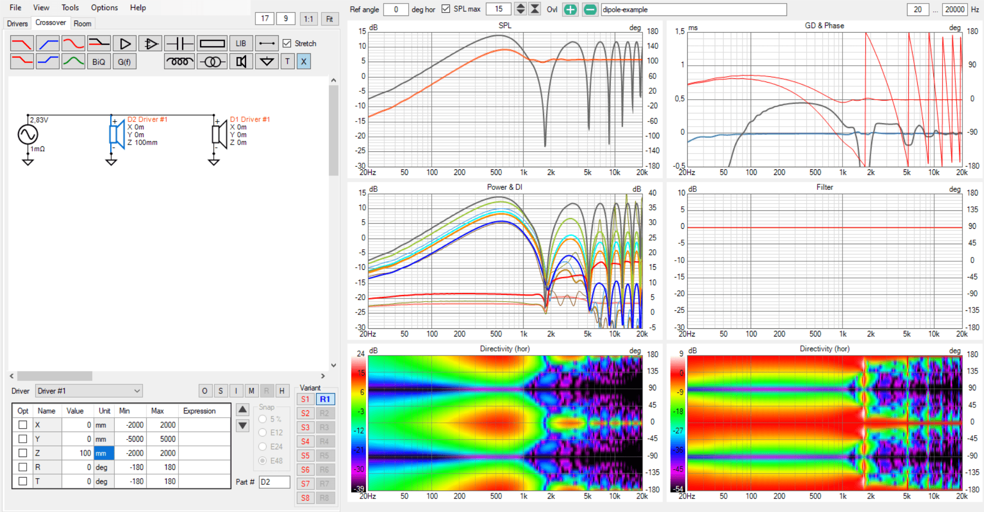

When distance of the two is increased, one behind the other, the usable bandwidth top starts to drop

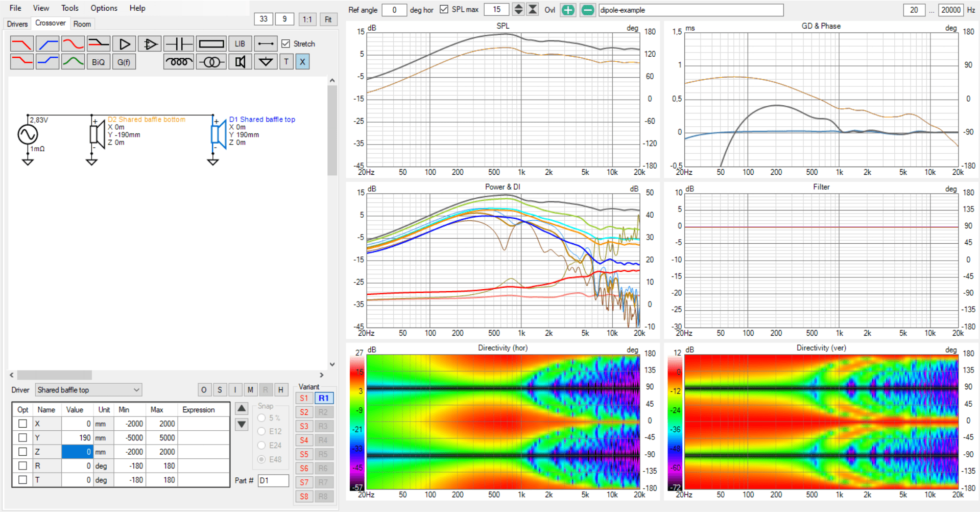

Here is situation where both drivers are on minimal baffle, one top of another not back to back like in above sims. Back to back configuration with 10cm spacing seems to be ~3db louder on the bottom than if the drivers were next to each other but I think this is how VCAD makes the ideal responses I think, just a moment I'll try it out. Also difference in DI, mainly in vertical directivity, unfortunately no Vertical polar map shown on the attachments but this is quick and easy VCAD exersize for everyone to try out 😉
Edit. yes, diffraction tool has total sensitivity referenced to 0 no matter how many ideal drivers, hence the experiment should simulate each driver separately on both cases to be comparable. Here is comparison that ought to match reality, also vertical polars directivity shown (normalized).
