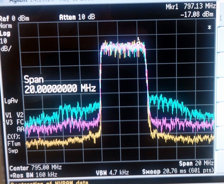

An audio amp can see a wide variety of loads, and that load will vary with frequency and amplitude of applied signal. It will also see a wide variety of music ranging from mellow to metal. There are far too many variables in play to build a predistortion algorithm unless some sort of adaptive learning is used. This was being tested for the RF (4G LTE) world when I retired 8 years ago. I have not followed that technology since I left, so I can't say what progress has been made, but DSP's have become WAY more powerful in 10 years.

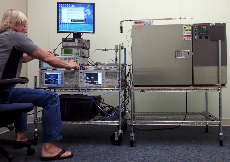

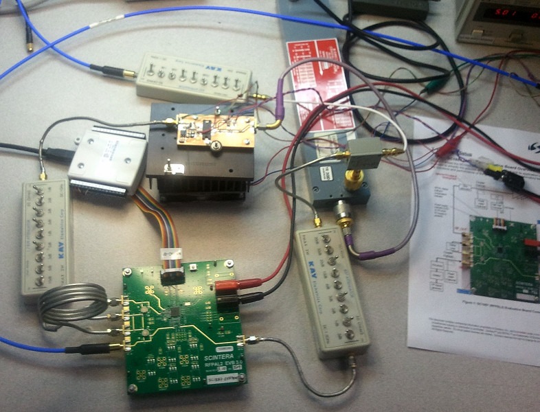

The spectrum analyzer photo shows three overlapping plots. The yellow trace is the input to the amplifier. It is a 5 MHz wide "block" of LTE signal with virtually nothing on either side. The space on either side of this signal is another RF channel that could belong to a different user. Intrusion into this channel is tightly regulated by government authorities, with ETSI controlling the worldwide standards. The blue signal is a test amplifier being pushed to maximum power output (about 4 watts) without predistortion applied. The unwanted emission is degraded by about 20 dB due to internal IMD products in the amplifier. This amp does not meet legal requirements and cannot be put on the air. The pink trace is the same amp with predistortion applied after several "adaptive learning" cycles. Predistortion results in about 10 dB improvement in IMD, making this amp just barely legal over all expected load and temperature conditions.
