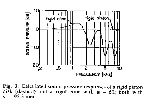

SY said:
I'm still trying to figure out what you meant by the term "smearing". Can you explain it? That's the only "problem" with cones that you've brought up and I don't quite understand it.
From the article "Loudspeaker With Honeycomb Disk Diaphragm", by Sakamoto, Satoh, et al in the Journal of the Audio Engineering Society, 1980:
"Another disadvantage of the cone diaphragm is the cavity effect....it is difficult to obtain a uniform frequency response because of the acoustic resonance of the front cavity and the path difference from each point of the diaphragm."
"For example, Fig. 3 shows the frequency responses of a rigid piston and a rigid cone, both 0.2 m [7.9"] in diameter. The sound pressure level of the cone has a peak at 1.3 kHz and a dip at 2.3 kHz. However rigid the cone may be, it is theoretically impossible to obtain a flat frequency response. On the other hand, for a disk diaphragm it is possible to achieve a flat frequency response by increasing it's flexural rigidity. This is the prime reason why the development of a disk diaphragm is so important."
