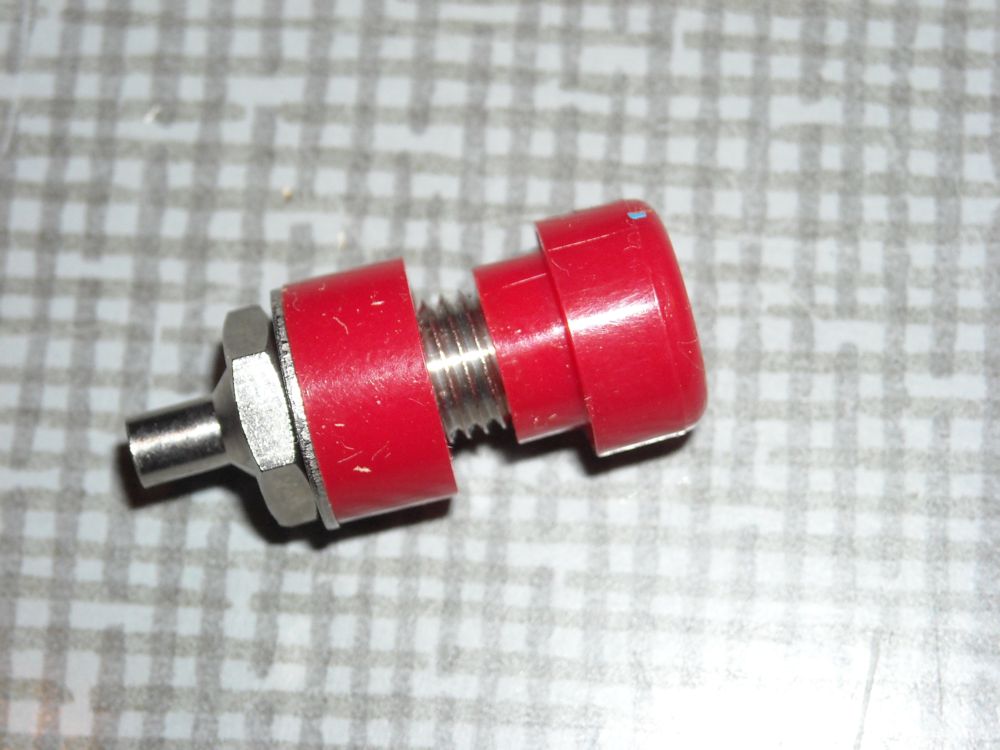

Funny I only thought of this now... (as opposed to before mounting the binding posts of the amplifier)
When mounting a connector onto the chassis a hole just slightly bigger than the diameter of the screw thread is drilled. Then the nut is turned to tighten the connect in place, with a plastic washer (or "thingie" in the case of binding posts) insulating the nut(s) from the chassis. This seems pretty standard.
But, since the space at the hole between the thread and the chassis is so small, shouldn't there be a high chance of the thread touching the chassis hence forming a short to ground?
Yet, when troubleshooting an amp and thought of this problem, I went to check whether there is such a short. Strangely none of the 6 connectors were connected to ground. Heck, if they didn't provide an insulator with the package it should be safe. But why is it safe to do so?

Or is it that the bottom of the washers (or the washer-like thingie for binding posts) are not flat on at least one side so that when mounted properly with a hole drilled according to datasheet the washer partially enters the hole and insulates the connector from the circumference of the hole? If so that's pretty creative.
Pic taken from datasheet of the Neutrik RCA that I'm using, washers colored red. I clearly remember other binding posts' washers having this bump at the bottom also, fatter though.

Went to check after I got home yesterday, the RCAs are alright because I drilled then according to what the datasheet says, but for the binding posts the inner ring is as thick (or as thin?) as that of the RCA it'd escaped my attention. As I was too used to drilling wood and plastic I drilled holes the size of the screw instead of the inner ring. So it was due to pure luck nothing blew up.
You'd think there should be more warning on this for beginners. I'm lazy to drill bigger holes at this stage so tape does the job.
