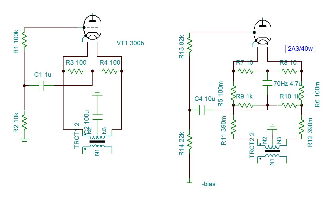

I understood why CETRON has bright sound when I replaced the 300B Shugwang with 2A3C of same brand . By applying an external 2.5V ac using the center tap grounded, I got far better mid and highs but where the bass did evaporate ? By reducing 5v to 2.5v using a pair of 0.5 ohm , I lost all the goodness of the highs but the bass reappeared ,loose , boomy . So I adjusted for best bass and added with high pass 70hz the highs . The spectrum of the got dramatically enlarged comparing to 300B . There I understood why WE used bootstrap , and why CETRON had bright sound .
My circuit uses two separate power supplies for the output and the driver to have directly linked .
