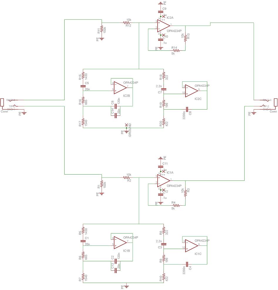

Sorry, noob question:
I'm working up an active filter circuit - in fact I've built it. It works as planned, but it has a noticeable amount of hiss. I'm'sure this is an EE101 question, but for better or worse, I never had EE101. Could someone point out the obvious? 🙄
By the way, the opamp are two quad packages, the TI TL054. I was hoping to share what this is for with the board, but it's not ready yet...
THANKS!

Opamp voltage noise... the TL's are intended for instrumentmentation apps with a zener (noise source) trimmed for low offset voltage. The good part is your circuit uses low value resistors and low gains to minimize the current noise (only with low impedance input drive).
