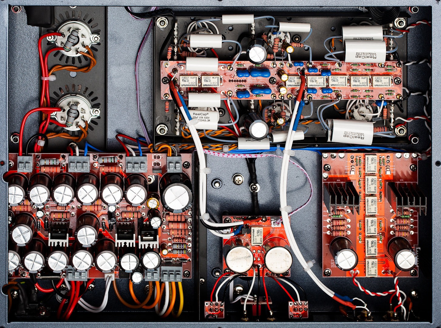

Take a look at this:Someone please post a picture of a really well laid out build to cancel out the anxiety this one caused.

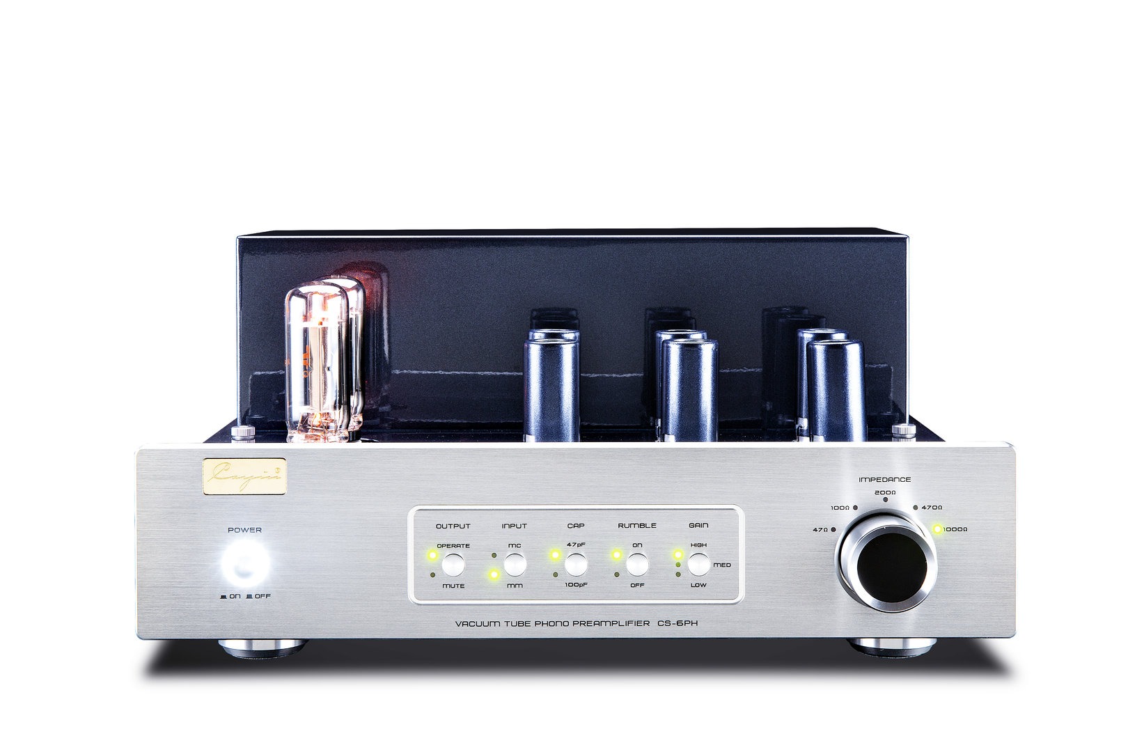

Although Chinese, the Cayin PH6 tube phonostage is very well done piece of phono stage,
both relating to build, component quality and sound....... and that for less then ½ the price
of the mess, that started this thread 😆🤣
