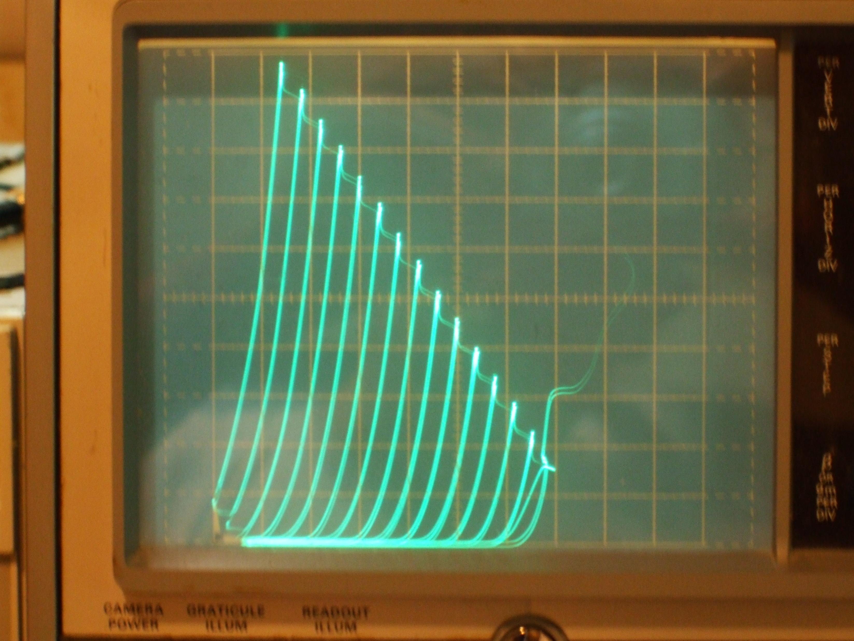

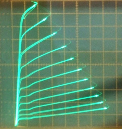

Below, curves for a 26LX6 TV Sweep with conventional grid 1 drive (fixed grid 2 V) and 26LX6 with Crazy Drive (grid 2 V, and grid 1 V proportional to plate current). Notice how the kinks have vanished.
Using the Crazy Drive configuration for N Fdbk instead, becoming "Crazy Fdbk" and cathode Voltage drive (not current drive as in cascodes), one can get straight parallel plate "curves".
No kinks, and no diode curves, just straight parallel lines. A wire with gain. Figure 3 below. (camera was hand held, a little shaking apparent)

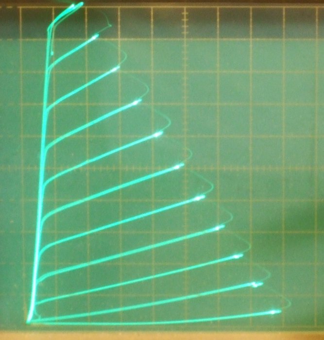

Just to be complete, figure 4 shows a $1 21HB5A TV Sweep using a conventional plate to grid 1 shunt Schade like N Fdbk with cathode Voltage drive. Notice the triode curves are a near copy of 211 triode curves, just a higher current scale and lower plate V scale here. Figure 5 is the 21HB5A in conventional triode wired configuration. Notice the roll-over in the curves producing 2nd harmonic.
On the hysteresis thing: I was using a TEK 576 curve tracer (modified for tube grid voltages). The 576 provides the option for all traces to be using the same slope of the 60Hz power or it can use alternating slopes of power line for alternating plate sweeps. One can see consistency between alternate plate traces that way, but differences with the other alternate trace set. No fuzziness in the traces, just solid lines that are alternatingly consistent, but inconsistent with the alternate set. So HF oscillation seems unlikely. I also have grid stopper resistors and strings of ferrite beads on the plate wire. N. Crowhurst once talked of tube hysteresis, I've solved it (at least for some tubes) The 6JK6 used in a famous receiver has terrible hysteresis without the fix.

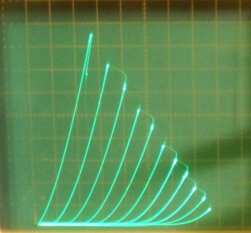

Your fig 1 shows kinking increasing as anode current is reduced, and then kinking reducing somewhat as the current is reduced further. I've seen that in some tubes too.
Some types do that in quite a pronounced way, and that does have me mystified.
I see your point about the actual plate and screen potentials staying the same (for this case). The variation in kinking here is related to either current change or grid 1 Volts change obviously. But the presence of beam current density itself changes the potential profile by just the presence of the distributed space charge. Not saying that is the cause, but could be related.
The grid 1 voltage would affect the micro beam focusing between the grid 2 wires. There should be an optimum grid 1 voltage for minimal grid 2 current, with screen current increases to either side of that optimum grid 1 voltage (over focusing or under focusing).
On the hysteresis, with 15 traces of alternating plate V sweep direction on the TEK 576, I see two different knee curves overlapped for each plate curve. (due to the odd number of traces causing alternating sweep direction for each curve set scan ) With 14 traces I see the pattern frozen, with alternate plate curves having the two versions of knee.
For 6JC6 (Japan version) and for 6JK6 tubes, I can cure the "hysteresis" by putting a small positive voltage on grid 3 (beam plates). I don't see how that could be VHF oscillation. I guess I could put the 7904 scope on it to see if any VHF is there. But I don't see how it could produce such coherent results on the 576. (well, as you say, rectification in the vertical channel could do that I guess, but then that would just be hysteretic VHF bursts, still a problem)
I don't see the problem occur with 12HL7, 12GN7, 9KC6 or 12HG7, all higher gm tubes. I think I did see this issue occur with one 7788 tube, but not with some others.

Now I see what you are getting at. I need to dig out some potential gradient plots ("rubber sheet" plots) to see if it is plausible.
Looping, as Tek calls it, caused by bandwidth limitations in the current sensing and scan circuits of the tracer, can look like hysteresis.
I find it really hard to accept that a vacuum tube can show hysteresis in characteristics. One thing I learnt long ago is that if a tube shows apparent hysteresis, it is oscillating so high in frequency your instruments cannot see the oscillation. Either that or it is a thermal effect of a faulty tube (grid wires sagging with heat) - this being a very rare problem.
The nature of VHF or UHF parasitic oscillation is that it comes and goes with quite minor changes in the circuit or tube voltages. One old timer's dodge is to put one's finger or just a bit of insulated wire on or near an electrode. If the curves change, its because you stopped or started VHF or UHF oscillation by adding a bit of lossy reactance.
A small voltage of either polarity (depending on the quirks of a particular tube and test environment) on the suppressor is entirely plausible for stopping or changing parasitic oscillation, as it would change both anode and screen gm.

You are correct in that Spangenberg (1948) describes in his Sect 10.6 a hysteresis effect in beam power tubes. He describes how this is due to a sort of internal positive feedback effect on the post screen space charge, working much like the action of a schmitt trigger circuit.
So I was quite wrong in denying hysteresis in tubes.
But note that this snap action at and below the anode curve knee looks quite different to the apparent hysteresis above the knee shown in your fig 1 in your earlier post. Also, Spangenberg's snap-back hysteresis mode is only applicable to beam power tetrodes and possibly to beam pentodes, but not applicable to pentodes like the 6JC6 that aren't "kinky".
So, I still think you are most probably mistaking parasitic oscillation effects for actual tube hysteresis.
The snap-back phenomena described by Spangenberg would, of course, be an effective cause of very high frequency oscillation (as Spangenberg points out in stating that it can be used to make an oscillator), which may well upset limited bandwidth instrumentation like curve tracers and tube testers, but only below the knee (region c'-g-g' in Spangenberg's Fig 10.15).
Regarding focusing effects making the kinking come and go at different anode currents - yes you definitely have something there. It should be possible to nail it down by measuring the ratio of screen current to anode current for sets of fixed anode and screen voltages, changing control grid bias so as to get different currents for each plot. This I intend to do, but at this time I don't have enough meters and accurate variable power supplies to set it up.
