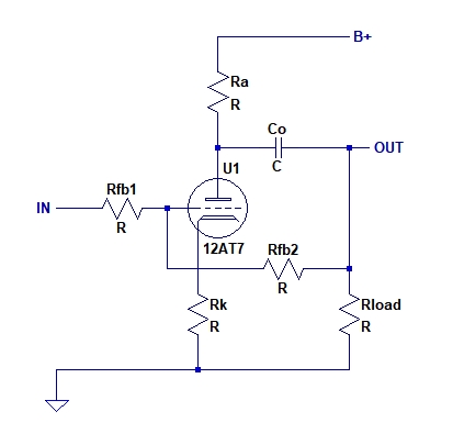

What about using up another 6DJ8 section as an anode follower on the output? Yes, the input impedance would be pretty low, but I could put the EQ between the first and second stages, and keep the input impedance of the anode follower output stage up at 47k ohms or higher. The output impedance should be low enough (1k or 2k, something like that).

I guess there's some confusion about what an anode follower actually is. I'm referring to the circuit where you take a common cathode amplifier and return negative feedback to the grid, so-called 'plate to grid feedback.' As in the attached drawing. Maybe there's a more correct name for this?

I guess my question back to you would be this: What makes you think nobody uses it?
I've used it with great success but like anything you have to work around the circuit's drawbacks.
It's just parallel-applied voltage feedback. I tend to prefer series-applied voltage feedback in most circumstances but sometimes parallel-applied feedback is the best for the situation.

I was thinking that if you need a line level output stage with a fairly low gain, say like 3x (10dB), and you don't want to use the 15mA or more required for a low mu triode (and you don't want to hassle with DHTs), then taking something like a 12AT7 or a 6DJ8 and wrapping parallel-applied voltage feedback from plate to grid can get you there pretty easily. Make sure the series resistor is large enough in value to keep the input impedance high enough not to load down the previous stage.

But from what I understand noise is a top concern. Parallel applied feedback can be difficult in some situations to get good noise performance since there is a largish value resistor in series with the signal. You'd want to make sure that the signal is large enough at the anode follower stage so that the SNR is good.
Without having attempted to calculate anything, I'm going to guess that noise is probably the reason not many people do it.

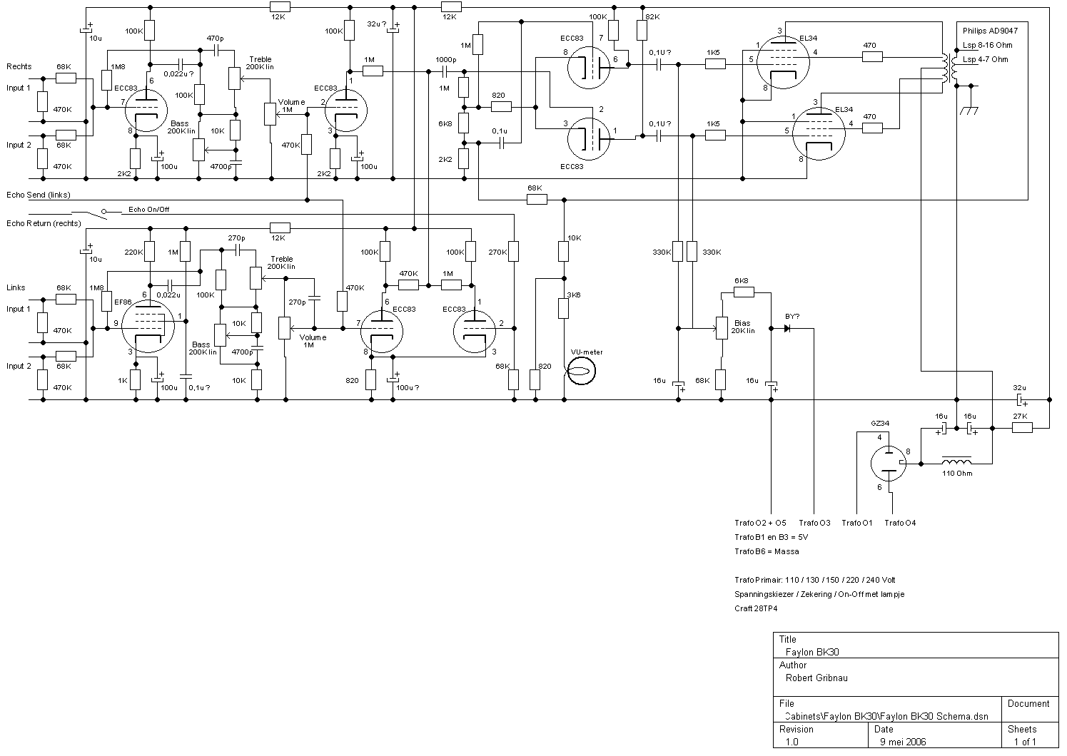

The Faylon BK30 guitar/instrument amp uses anode to grid feedback in both channels (and has an ultra linear power stage with an OPT of Hi-Fi quality).
Faylon was a Belgium manufacturer of guitar/instrument amps (closed 1977). The Dutch band "Golden Earring", for the rest of the world best known by their hit "Radar Love" (1973), used Faylon equipment for some years.
I own one and love it for it's clean sound and it's quietness (no hiss or other noise).
