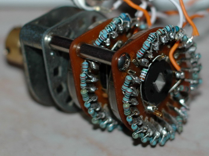

Yesterday when I looked for parts, I found my old (about 15 years) rotary switch based attenuator, about 250k (I do not know why), made for a Marshall Leach long time ago.
Just to compare, we changed to this for a bit. It took about 5 seconds to realize, this old ladder from mixed type resistors kicks both network and black alps EASY, very easy.
