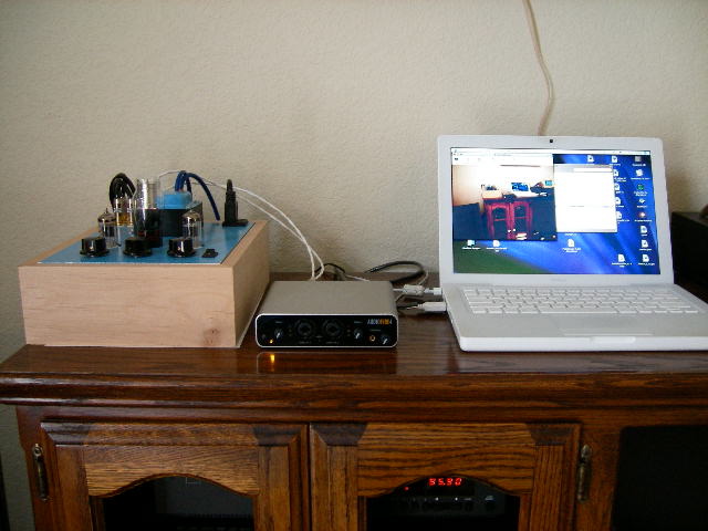

I have the tube pre-amp in the daisy chain string to have a quiet source switcher (FM tuner, Oppo DVD player and of course my iTunes / Mac Internet radio feed) and an impedence matcher ... and to take the edge off and mellow out any clipped signals ...
