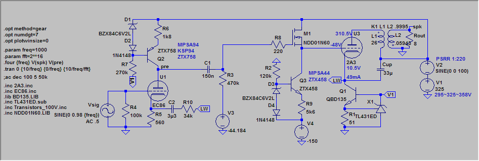

So I had another look on one of my designs I had in the drawer. Yes, it addresses the excessive heat dissipation by replacing the cathode resistor with a CCS. It is in fact a CCS everywhere design 😎, the first two stages being RC coupled and the driver to output DC coupled. And yes, the LW compensation still kind of works. Not as good as in the fully dc coupled designs, but still (per simulation) at a ratio of 1:220 or -47dB if I'm right. Not stellar, but acceptable.
Btw, by employing CCS's thruout and using a mosfet power driver, this circuit achieves some very desirable properties...
  • low power consumption, only ~17.7W per channel (w/o heaters)
  • no adjustments anywhere, just roll in any tube
  • very resilient against mains voltage fluctuation, much more so than auto (or even fixed) bias
  • can be driven into class A2 for ~5.4W of output power
  • draws a constant current at any time, per channel and thru every single stage, reducing x-channel and inter stage interference and greatly relieving the PSU.
  • This also holds true when driven into A2!😀😀
    (With the exception that the current thru each stage is no longer constant, but for the driver + output stage in total sum)
Yes! The grid current spikes during A2 operation circulate in a closed loop formed by the mosfet, tube grid & cathode, ultrapath cap and the B+ rail section connecting back to the fet's drain. There is no impact on the PSU or input stage. 😎🙂

You could simplify this circuit by doing away with the DC coupling , ultrapath cap , mosfet buffer and go fixed bias . This will remove a load of sand , reduce heat dissipation and simplify the power supply . I really do not see the point of having A2 capability , you may as well allow the driver to soft-clip . If you need more power , go up a valve to 300B . As for wimpy driver valves : I do not like them . Always flat-sounding HF with ECC83 7B4 etc

Obviously there are simpler circuits, but that wasn't the point. And, everything's there for a purpose.
Once you insert the fet driver + ccs, the dc coupling comes for free (no extra effort).
Fixed bias requires extra adjustments at regular intervals and on tube swaps. It also requires extra parts for the bias circuit. It is also quite prone to mains voltage fluctuation. The cathode ccs avoids this. It does not require any adjustments. The neg. bias voltage (-44.184V in the diagram, the exact value is not so important) supply can also be shared between both channels. Extra dissipation is quite negligible at ~0.5W.
The ultrapath cap, besides sonic advantages, also greatly relieves the PSU and actually allows for cheaper, simpler design in that area.
A2 operation increases the available output power by ~ +40%, and essiantially for free once you insert the mosfet driver. Extra dissipation thru this stage incl. the ccs is ~0.7W.
For comparison, the dissipation of the tube input stage is ~1.1W.
Of course for more power you could go 300B, but only at other further expenses (higher plate dissipation for higher power out, hum issues with ac heating, higher tube cost,...)

Fixed bias will vary with the mains supply , providing it's not regulated , although on tube swaps will need resetting . You have a coupling capacitor from the input stage to the driver so strictly speaking the amp is not direct coupled . I'm still wondering why anyone would even bother trying to squeeze as much power out by driving the grid positive on a low Ra output valve . This , to me , makes no sense as your 40% power increase figure is only a dB or so . There is also the issue of distortion when the grid approaches OV and goes positive . I can see you are considering the peaks but if you are driving the output valve like this , you may as well build more sensitive speakers so your amp cruises along in low distortion territory 🙂
Which will burn huge amounts of power, comparatively, to the ccs'ed circuit, when designed for +/-10% mains voltage.
With the circuit shown, there will be no extra distortion due to grid effects on the output tube. The fet follower is a giant in drive capability, and a wimp in power requirements only.
The TL431 on current sink might need a stability check. The info is very good . A LED works and needs none.
http://www.ti.com/lit/an/slva482a/slva482a.pdf
The TL431 has tight tolerances and low temp variation. LEDs probably not so. A LED probably requires a trimmer to set the cathode current. A LED also requires much more current thru it for stable operation as a voltage reference. The TL431 is fine with 1mA.
What would be the potential stability issues with the TL431? The BD135 follower's capacitances are tiny tiny.
