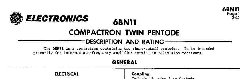

Some time ago I tried to make a differential amplifier using a double pentode compactron tube. The data sheet clearly say "twin pentode", not "dual dissimilar pentode". When trying to balance the plate voltages, it was impossible. Then, after some tests, I wire together cathodes, grids, screens and suppressors, wired to proper voltages. Only plates were maintained separately, tied to EBB with two matched resistors. Surprise: one section draws 3 times the current than the other.
I imagine that if such a dissimilar characteristics in two tubes in the same envelope, why not still bigger ones in differents brands...

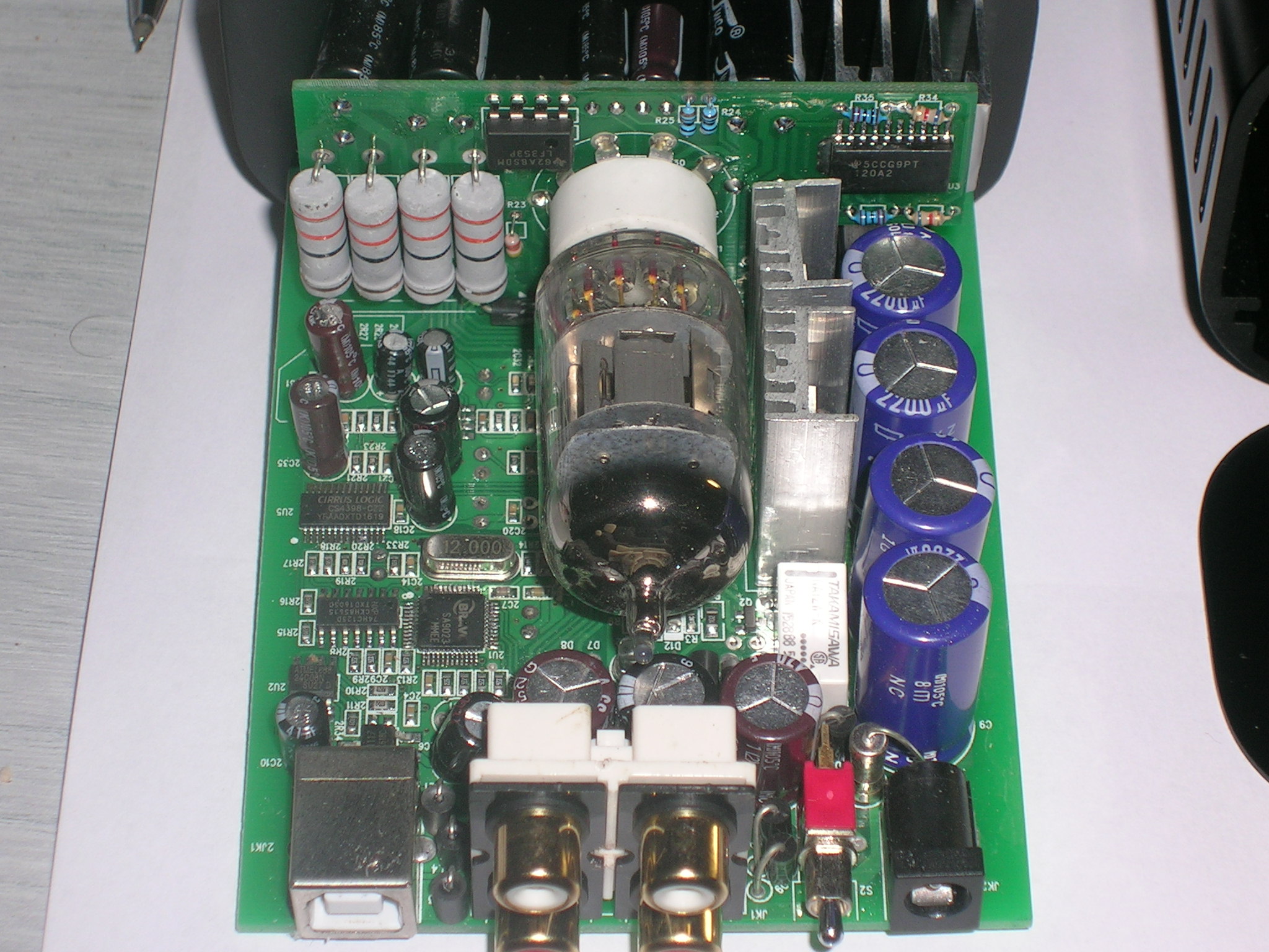

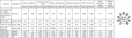

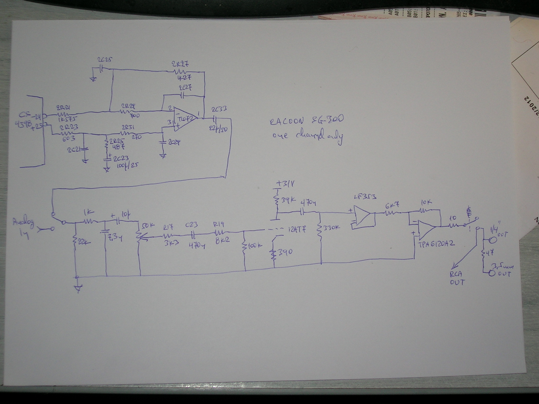

A few months ago I was listening to changes in sound while changing a tube in a friend’s headphone amplifier.
I was surprised and I started measuring DC voltages at the pins of the tube socket.

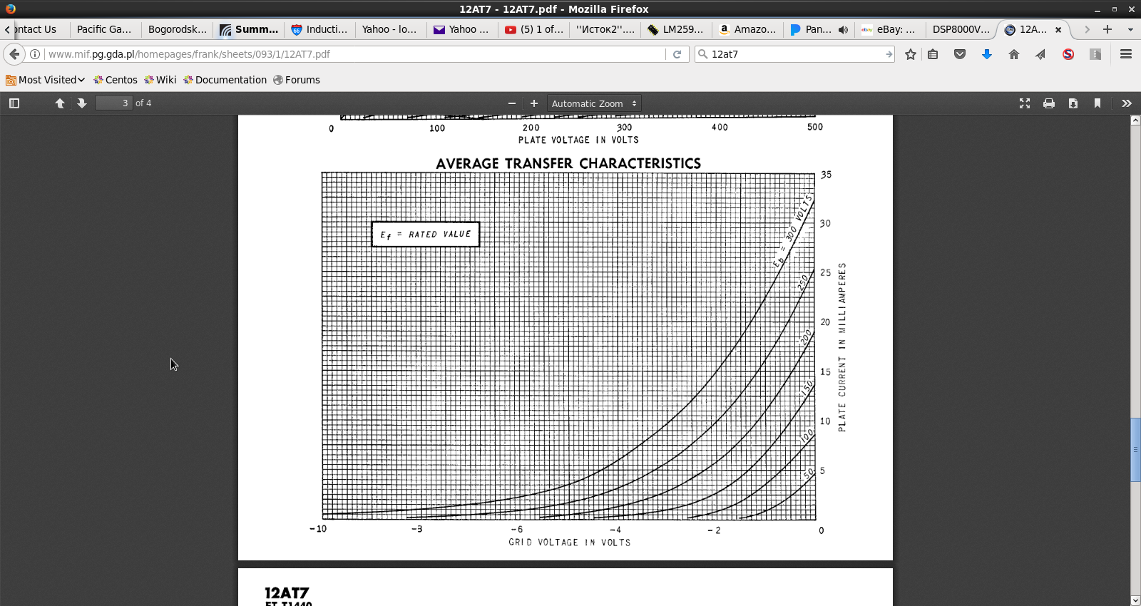

George, this effect box as if was designed for such troubles. 😀
You can see form of curves for 12AT7 on such voltages and currents. Slight changes of values of resistors in anode and cathode would change the sound even more. No surprise here!
Yes I agree Anatoliy. This example is at least sub-optimal.
The surprise is the static dc differences among tubes and among the two sections of the same tube.
George
George

Very interesting, George. Were you able to draw a y conclusions between what you measured and what you heard?
That's exactly what Morgan Jones reports on 6SN7's in the 3rd edition of his Valve Amplifiers book. Hence he recommends pairing from some batch of individual 6J5 triodes.
The A No. One problem with trying to do that is these dual pents were intended to make two stage IF amp cascades, not differential amps. Attention to balance wasn't an important consideration, and so wasn't maintained. Being that out of balance was of no consequence when used for its intended purpose.
I used 8BN11 in several amps. However, not as LTP, but as drivers for 2 separate channels. Very nice tube! Yes, dissimilarities are like when you use 2 separate pentodes from the same batch, but so what? Nothing is precise in the nature.
Also, I used in LTP driver stages a QQE03/12 designed for UHF PP amps. And they required to balance bias between halves, even though used different sides of the same cathode!
