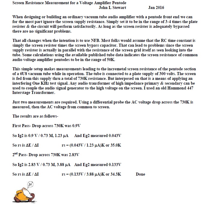

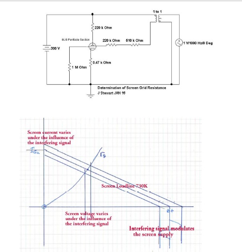

Screen Resistance Measurement
The information on that graph is very useful, in particular in the designing of a NFB amplifier. Here is one way of determining screen resistance of the screen in a pentode.
I'll add to this later, an example of the information as applied to a on a common FB amplifier..🙂

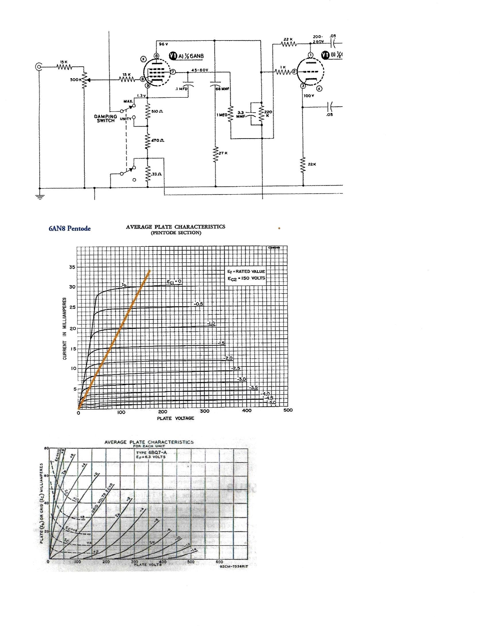

Estimation of Screen Resistance with an Example
This one is the front end of the Heathkit UA1 Amplifier. The screen resistance & its bypass cap forms part of the NFB stabiliztion.🙂
More to go as I dig it out. All these reports are on PDF but for some unknown reason folks on DIY don't take the time to open.😀

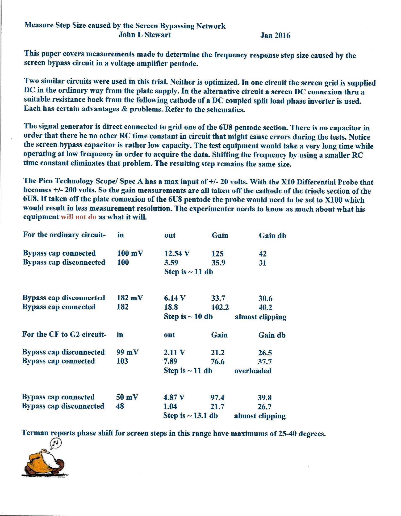

Step Size due to Screen Bypass
Here are bench tests to determine the change of gain due to the screen bypass. Something designers need to know when working on a NFB amplifier.

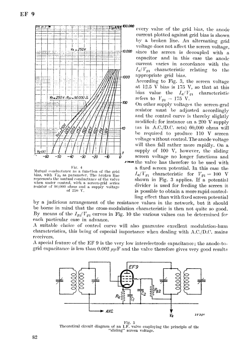

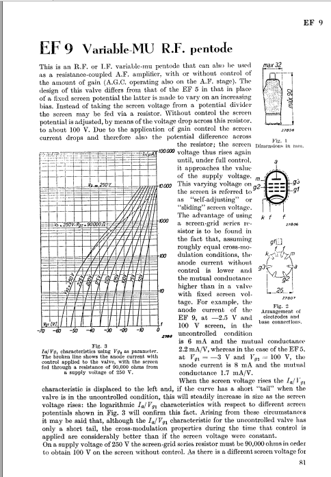

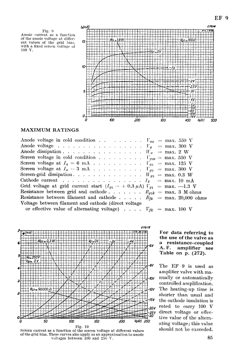

According to Philips the EF9 was their 1st Variable Mutual Conductance valve featuring "sliding screen grid voltage" operation as If / HF amplifier for improved gain control.
Requires a very high value unbypassed screen resistor.
Hence the respective curves in the data sheets.
The EF85 is one of the successors for this service with similar characteristics.
Philips_ElectronicValves_BookII_1949 has a detailled description for the EF9 on pg. 81-85.
Yes, that is THE reason to document that specific screen resistor. In fact that is one reason I got a copy of Philips 1949.
But that is NOT relevant on a Hi-Fi chat-group, and there may be NO good(*) reason to use this class of very-bent tube in good audio.
(*)It directly extends the "undistorted" dynamic range of a compressor. There's alreayd far too much compression in recordings, and IMHO if you need more you do it digitally.
