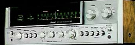

Sansui, Pioneer, Denon, etc. Of course, if you don't connect them to serious modern speakers it's all for naught.

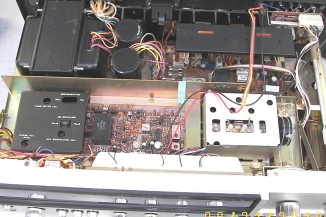

The old Tandberg receivers are lovely, and I have a soft spot for the old Japanese "garden of lights" receivers with the wonderful flywheel tuning knobs before varactors and digital displays took over. I'm curious about the guts of the Tandberg stuff - anything special?
