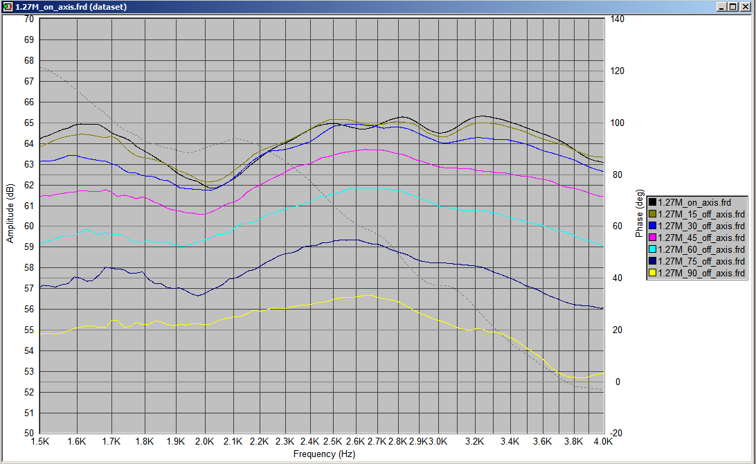

So did anyone actually ask the question "what is cheap?" I certainly would not have called the hiquphon OWI a cheap tweeter!!! !
I'm very happy with my Morel DMS37's (definitely cheap compared to the hiquphon) but not what I personally would have called cheap. Terry will know where I'm coming from, as he is the one who let me in on the secret 😉
Just curious (based on Simon's comment about narrowing polar at the crossover frequency) if anyone can pick the crossover frequency from the attached plot. No cheating if you have seen my thread 😀 and a hint it Isn't between 2 and 2.1Khz 😉
Tony.
