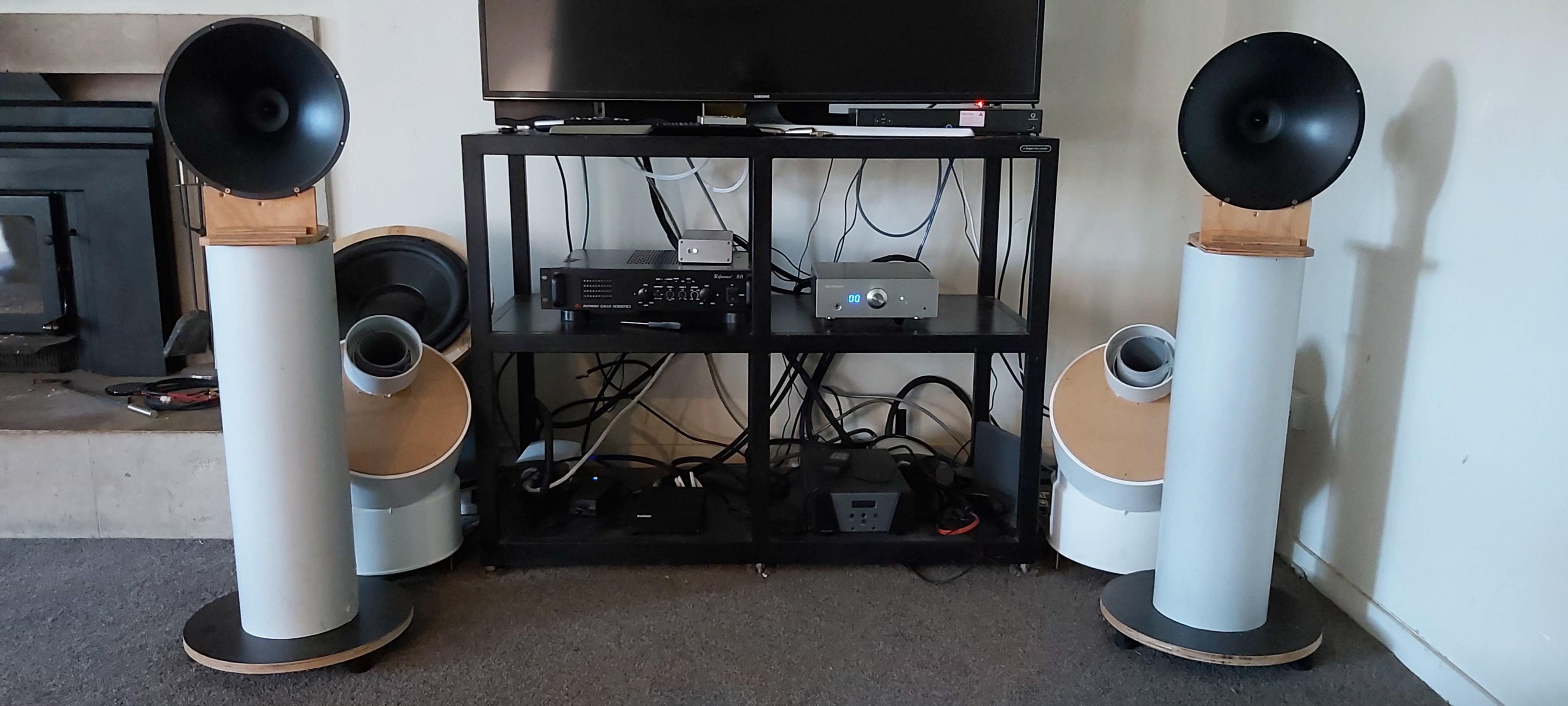

Actually, I have a couple of pairs of 10-inch drivers and in sealed enclosures weren't quite developing enough visceral bass. So I wanted to see if I could extract a bit more oomph simply by porting them. And I have, though I'm led to believe I really need enclosures twice the size for ported speakers compared with sealed.
Anyhow even as they are, they seem improved to me. I'd always steered clear of ported enclosures because of reports of one-note bass etc, but in the enclosures I use Im not getting that. They are essentially bent cylinders, with routed wooden end caps.
As in the attached (the white Minion-like enclosures behind the waveguide speakers).

Forgot to mention; not using a plate amp, although the 15-inch sub has its own Gallo Ref stereo sub amp).
The waveguides are driven by a chip amp, and the 10-inch woofers by N-Core 200wpc amps. Active crossover, only using low pass set at 200Hz. So separate volume controls for waveguides and woofers.
