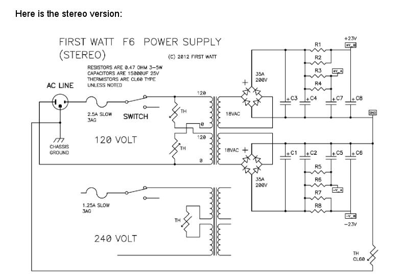

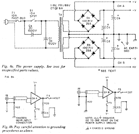

Unfortunately the US hobbyist's first choice of transformer vendors, Antek, sells very VERY few transformers with four equal secondary windings. So the Pass A40 power supply design, which requires four secondaries (two for 88 VCT number 1, and two more for 88 VCT numner 2), is not feasible.
Antek-sourced hobbyists choose either two transformers to get four windings, or one doublesize transformer with two windings shared between stereo channels, or monoblock construction.
You might consider the "First Watt F6 Power Supply (Stereo) version presented here: http://www.firstwatt.com/pdf/art_f6_baf.pdf. This supply uses a power transformer with only two secondary windings, but separates the 2nd stage of the CRC filter using extra capacitors.
I noticed the same thing with the F6 power supply. Commonly done on tube amp PS's. One thing to consider with Anek PS is that you can use smaller transformers 150VA or 200VA and stack them on top of each other. The same with the PS and then have 2 mono's essentially in one case. Most cases are tall enough where this can be done.
The schematic in post#9 gives armchair analysts a delightful opportunity to guess (or to calculate), what value of the ratio ((C3+C4)/C7) gives the best sounding amplifier?
What's the best construction/assembly method, that makes it relatively easy and painless to try out different ((C3+C4)/C7) ratios in the final amplifier, for critical listening tests?
What type of source material reveals these sonic differences, most obviously? Female vocals? Sheffield Drum record? Chamber music? At what volume levels?
