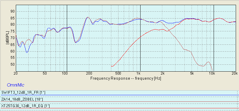

Here's my 2-way with a ZA14+XT25 1 meter above the floor. Nice deep notch at about 150Hz. I don't get the hump lower down because my room is not entirely closed. At the other end of the room, there's an open staircase that leads to the floor below. It acts like one huge bass trap.
Regards
Mike

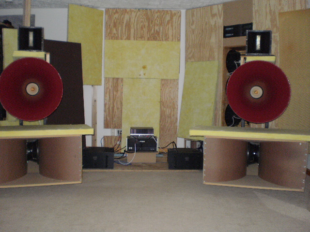

So you chose an 8th order filter? That's rather steep. Is that an electronic network order, or a resultant acoustic slope of the horn? Have you time-aligned the outputs of woofer and TB 1772?
I wonder if I am going to need time-alignment anyway, even if I go with first-order crossover. If we take a woofer and a small fullrange driver, their acoustic centers are not going to lie in the same plane, which is probably going to screw with the goal of achieving transient-perfect response.
Greetings !
To answer your questions:
1) Yes, it's the actual electronic network slope: 48/db/octave. The acoustical resulting slope is even steeper, and could be asymetrical, but is of little concern to be personaly, because it's so far down in level that the aberations are small compared to the room's signature.(Even though my room is heavily damped against reflections).
2) Yes, all drivers except the sub-bass are time aligned.
And to review, the x-overs are @ 60Hz, 250Hz, and 3500Hz. It sounds really good, but the only thing I'd like to experiment with is adding some additional subs that carry a slightly different range, as per the Geddes article I read about using multiple subs. The deep, deep bass will still (obviously) be produced by the infinite baffle, and I'd like to add some bass units that might carry up to around 150hz, where I can replace the "stub horn" with an actual horn for the lower mid range.

Have you considered some baffle step compensation ? Saddle that forms from 200Hz to 800Hz might well be because of baffle step effect, taking baffle width into consideration that is about 15cm-17cm (6-6 3/4") by my rough assessment. I'd try to put two pieces of plywood to sides of the box and measure it just to see what happens.
Distortion looks awesome btw.
