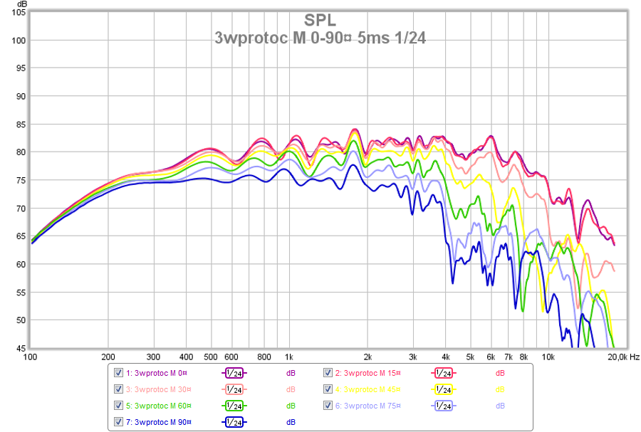

Here is hor. polar measurements of a 4" mid in narrow baffle, and a 3-way with it. Sorry but I don't take the measurements of xrk's 5" FAST for valid. In my speaker 60¤ is -5dB at 3,5kHz and drops suddenly to -10dB at 4,5kHz. Cone profile and dustcap/plug play a role here too.
Read the angles on his plot.Sorry but I don't take the measurements of xrk's 5" FAST for valid.

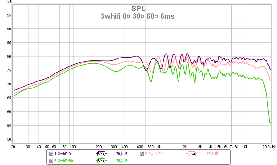

It makes for a simple xover, measures well and sounds better than most of the loudspeakers that are on the market for fraction of the price. Here are the measurements on axis, 30 and 60 degrees in BLH cabinet:
Here is the response with Beyma bass added and xovered at 290Hz (that nasty dip at 200Hz is floor bounce as GM calculated 30-40 pages ago 🙂 ):
