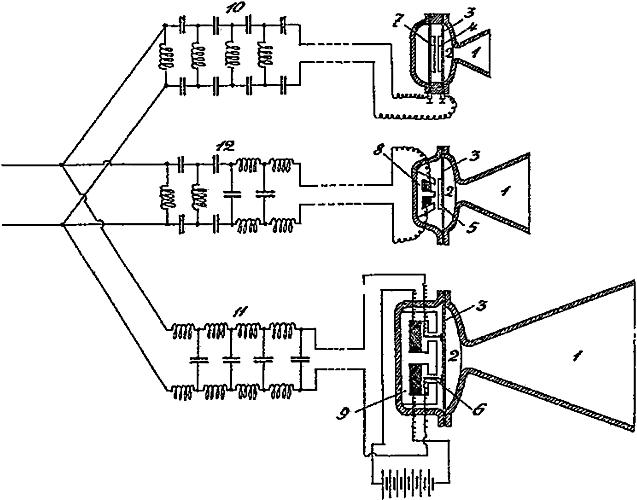

Looks like high pass, bandpass and low pass filters feeding a 3way.Recently - I am listening Walter Hanemman (patented 1928) crossover concept
in reduced and symplified form for my system.
And I wont back to "classic" non-working-mediocre-sounding standard crossover concepts
Very standard crossover.
