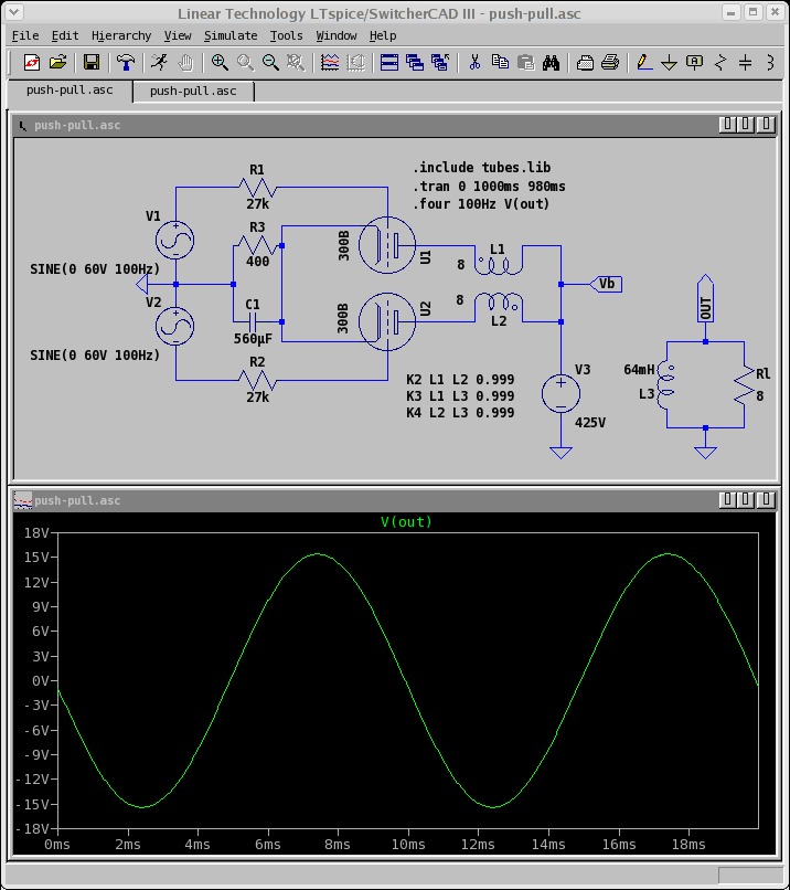

As you can see, the cutoff is modelled correctly (and it is easy to do for 300B, which is a hard-cutoff tube). The average model error is ~1.4mA.
OK, so if you can't blame the model, then it really IS a poorly designed circuit. Try modelling again, but with a 4x increase in plate to plate load compared to SE, and with the idle current chosen to minimize distortion instead of maximize it. Then your simulation might give you something closer to how competently designed real-world push-pull AB amps measure.
Leaving SY's implications of my competence aside, the answer to his question is this: with 12KCT:8 load and the same bias as in original example you obviously get less distortion - about 6.5% at 12W in Class AB2 - but much more than what is achievable in Class A. More instructive is the answer to the second suggestion - vary the idle current to minimize the distortion. Distortion is more or less monotonic function of idle current, with distortion figure always best at largest available idle current - i.e. optimizing Class AB stage for distortion you are driven to Class A operation. There is no "sweet spot" in idle bias. This has been generally true for all triode push-pull stages I've modelled so far.
A couple of questions:
1. What's the B+?
2. Why is the source impedance of the driver set at 27k?
1. What's the B+?
425V.SY said:1. What's the B+?
No particular reason. A convenient value to represent grid-stopper resistor + previous stage impedance. It is irrelevant for the point I'm trying to make, as the grid current draw is not modelled, and Miller capacitance is too small to cause trouble at 100Hz. If I were designing a Class A2 stage, then I would worry about it 🙂.2. Why is the source impedance of the driver set at 27k?
Thanks. In a real AB2 amp, you'd want a source impedance well lower than that.
If, for this tube and this model, your sim shows distortion decreasing monotonically with increasing idle current, you should set that at something more like 85mA. Why use a 40W tube and not run it at 40W? I'd be curious to see what your model predicts under those conditions.
I haven't used 300Bs in p-p AB (there are better tubes for this application), but in one published circuit I have at hand (C. Schafer, "30 Watt High Fidelity Audio Amplifier" Audio Engineering, July 1947), with a 425V B+, 80mA idle, 4000 ohms plate-to-plate load, the measured distortion of the entire amp (no loop feedback!) was under 2% IMD (40Hz/12kHz) below 22 watts. Not too terrible, but I'll bet some playing with load lines could come up with something better.
At 425V B+ and running at 85mA idle per tube into 4kCT:8 load, the stage models really well. You get 15W out at 0.1% distortion. I would not believe that number too much, but distortion is definitely low. (In the real amp, some second order distortion will creep in from the tube mismatch.) Getting comparable distortion from a driver is going to be tough...

Hi Andrei,
I quite obviously owe you an apology, I had heard mistakenly that the software did not do multi-point curve fitting when it is obvious that it does, and the curves look like a really close match in the model.
Your observations about the monotonic variance of the distortion in a 300B PP output stage jibe well with my previous experience in two 300B class A PP amps I designed, this incidentally appears to be true of 300B SE output stages as well, thd continues to decrease linearly as the quiescent current is increased to the point where the tube would actually self destruct. (I stopped just short of that point.) There may be no measured "sweet spot" but sonically there usually is and imho it is not usually at the minimum distortion point, but perhaps at a point where 2nd harmonic is slightly favored over third.. (Have not investigated this phenomena in PP amplifiers, have clearly seen this in SE amplifiers however.)
My last 300B PP amplifier runs in class A at 80mA/400V per tube and manages >30W @ 2% thd, and as I recall is predominantly 2 & 3rd harmonic. (Obviously most 2nd harmonic should be cancelled in the transformer.) Transformer is 3800 ohms plate to plate. Driving a pair of them to this power level requires differential drive of about 320Vpk-pk which is getting close to onerous with non transformer coupled driver stages.
No problem. That just goes to show that I need to document the damn thing properly 🙂. Well, maybe one of these days...
