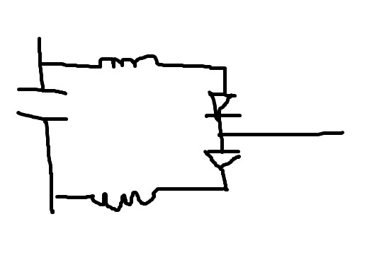

If you look at the equivalent circuit for the output stage you have the cap across what are effectively two diodes. These 'diodes' are the B-E junctions of the output devices and mean that as long as the junction is intact (including being short circuit) then no significant voltage can build up across the cap to cause failure.
But if one driver failed, it can... no ?
No. If one driver failed you would have (depending which driver) a high positive or negative voltage applied to the cap but the cap still sees little voltage across it. The B-E junctions of the outputs act as a clamp.
Something else would need to fail as well for the cap to see a high voltage.

This is an initial build by an amateur. It is quite likely a bad solder joint is causing a large DC voltage on the failed cap. not a failure of a driver transistor open (which would be rare). OP needs to measure DC voltage at the position of the failed cap, both positive & negative terminal.No. If one driver failed you would have (depending which driver) a high positive or negative voltage applied to the cap but the cap still sees little voltage across it. The B-E junctions of the outputs act as a clamp.
