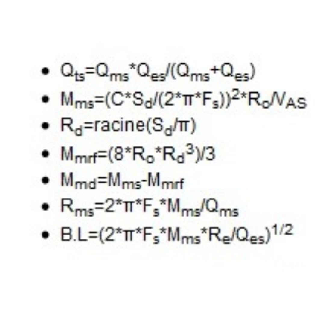

In essence to have the same essential T/S-parameters, 4 and 8 Ohm drivers are very different below the surface. You want the 4 Ohm version and 8 Ohm driver to behave similar to each other (other wise they would be two different drivers). That means you want to have at least the Fs, Qts and Vas to be very similar for both the 8 Ohm and 4 Ohm version.
If you look at this formula:
For Qes (plus Fs and Mms) to remain the same, if Re halves (BL)^2 should also halve. That means BL should be 1.414 times lower, as 1.414^2 = 2, so that is close to that 1.3 value that you found.
Usually the Re of a 4 Ohm driver isn't exactly half that of an 8 Ohm driver and because of the wire change (thickness/ length, etc.) Qes, Fs and Mms (amongst others) can also change a bit, giving a deviation from the theoretical 1.414 factor.
