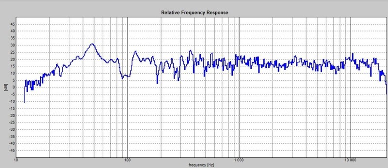

I don't seek to add or tweak the sound of my systems. What I basically aim for is consistent FR in different rooms, and most importantly, control of room modes that need room treatment that many would consider beyond normal WAF.
My current digital EQ, applied on a PC music server, does minimum phase FIR EQ for each room, based on measurements using a calibrated mic. Transparency has not been sacrificed. Reducing room problems has increased transparency, and it's must easier to hear differences between dacs, capacitor upgrades, etc. Soundstage is improved. Dynamic range is improved (fewer boomy notes). Really all I've done is re-jigged the speakers to match the room. If I could start afresh, I'd get speakers without passive crossovers, and only use digital crossovers, but strictly speaking it's still EQ. Applied in this way, I simply cannot understand why any 'purist' should pooh-pooh EQ.
