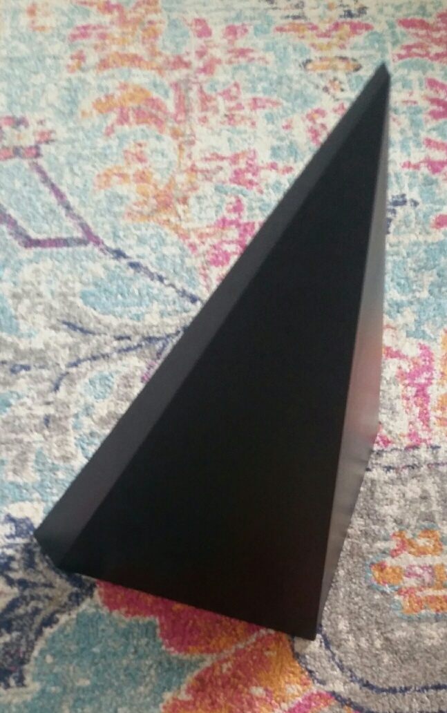

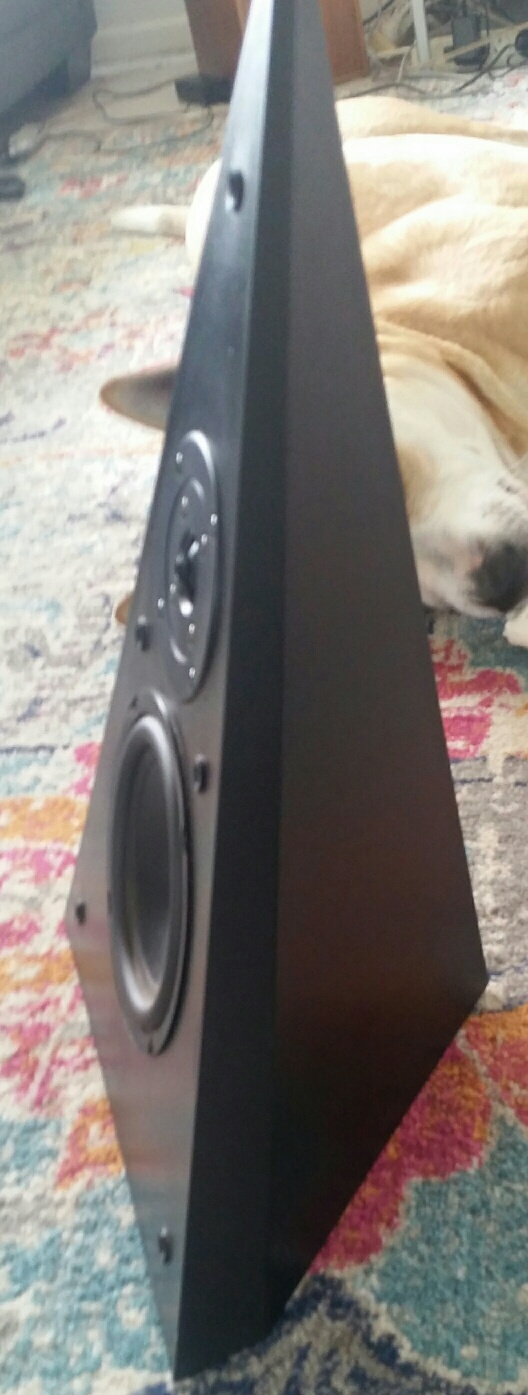

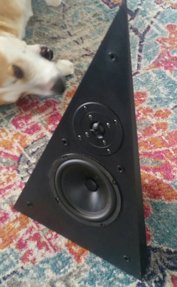

Well what are the chances? Had to grab them.
Picked up locally for a measly $15. Random brand name of Opus One, can't find anything about them online.
Reasonably sized woofer magnet, simple crossover, lightweight enclosure but could certainly be modified.
Bright clear sound, decent vocals.

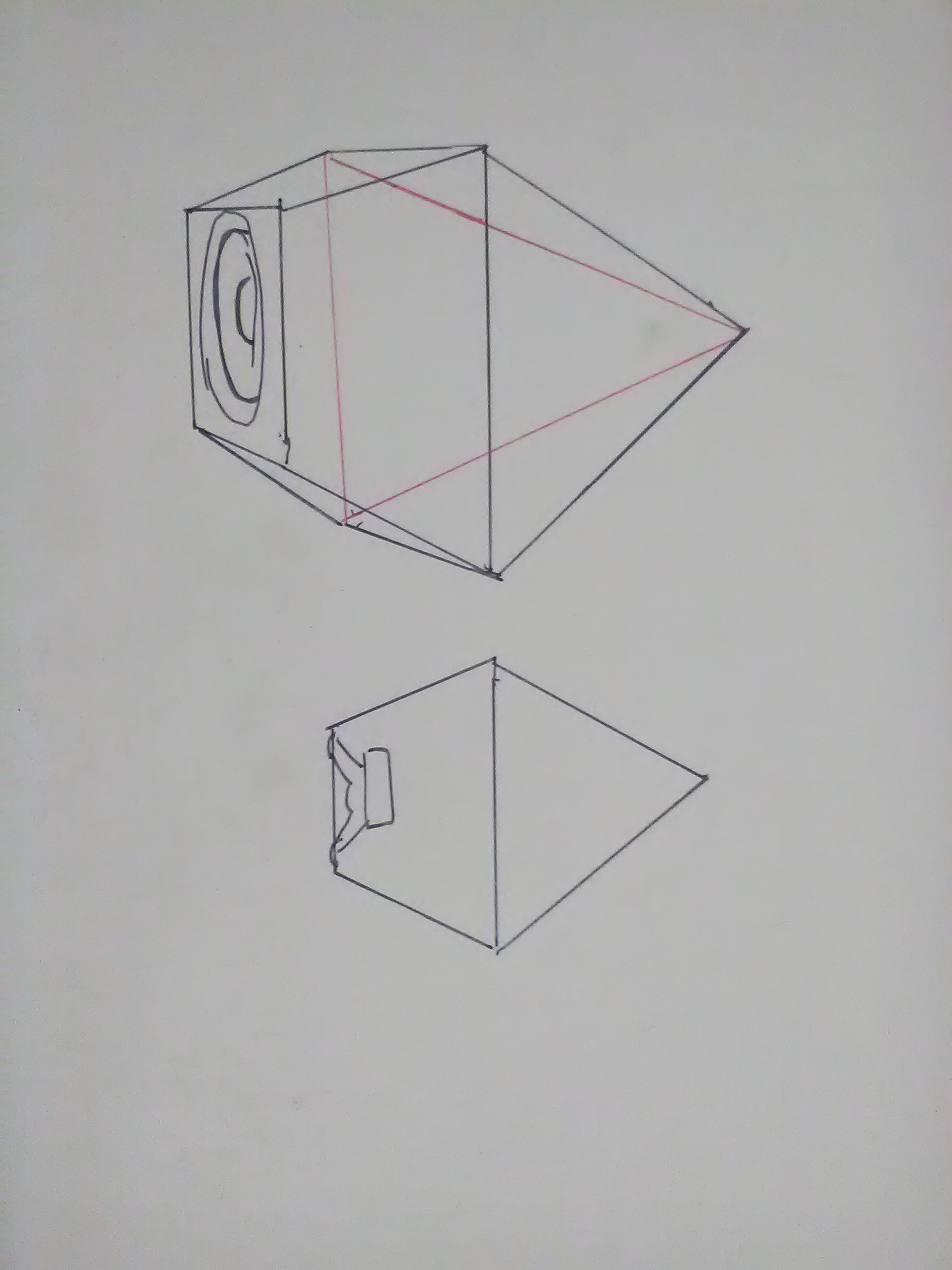

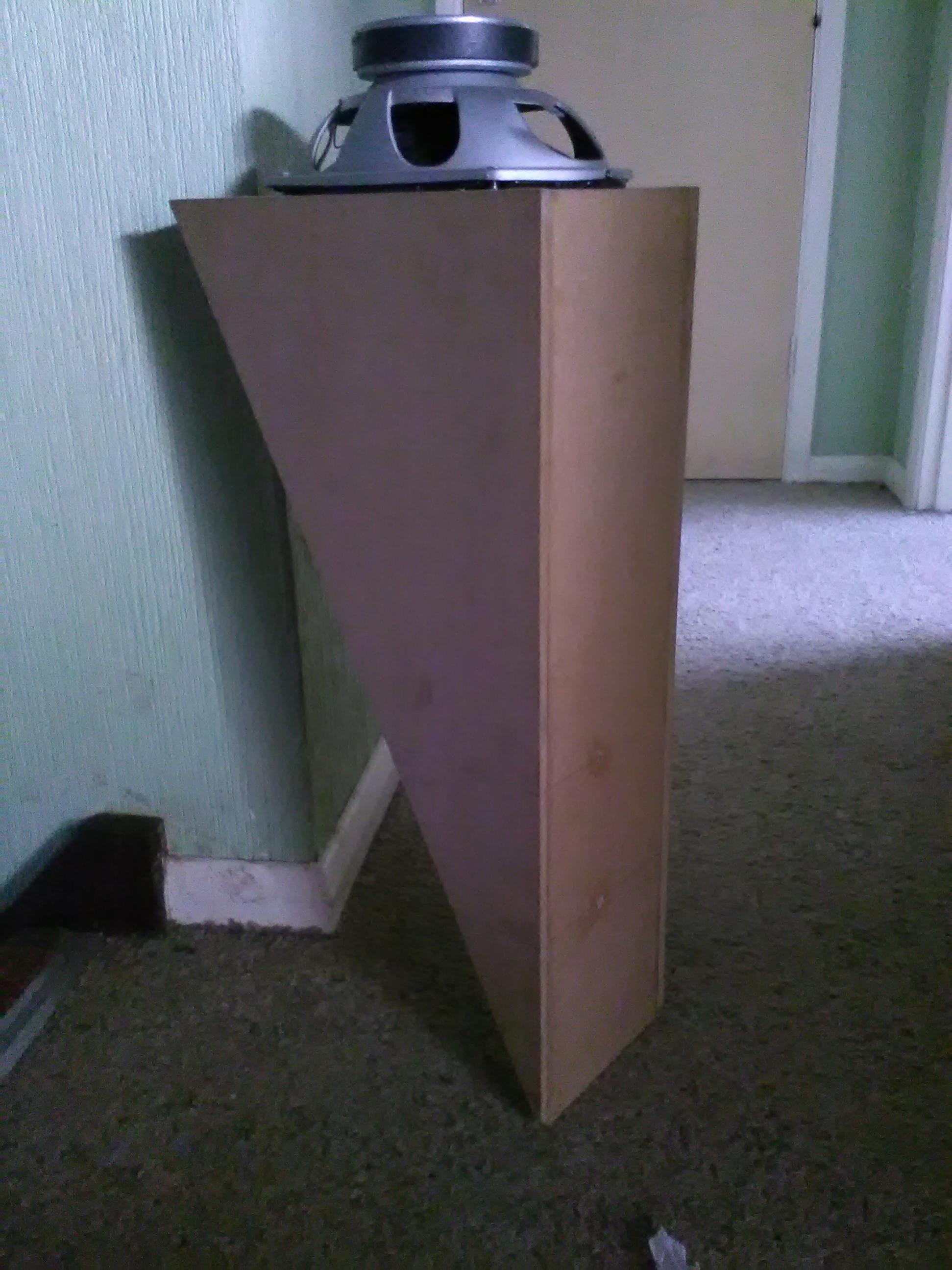

I think I'll probably end up laying them flat with a full range unit in the end, so quite similar the dagger transmission line people talk about.
Very much along those lines yes but I can't promise that that plan won't change a million times before jigsaw blade hits wood.

I might brace and stuff the enclosure before running some eq on them initially before I think about heavily modifying them into a long dagger enclosure.

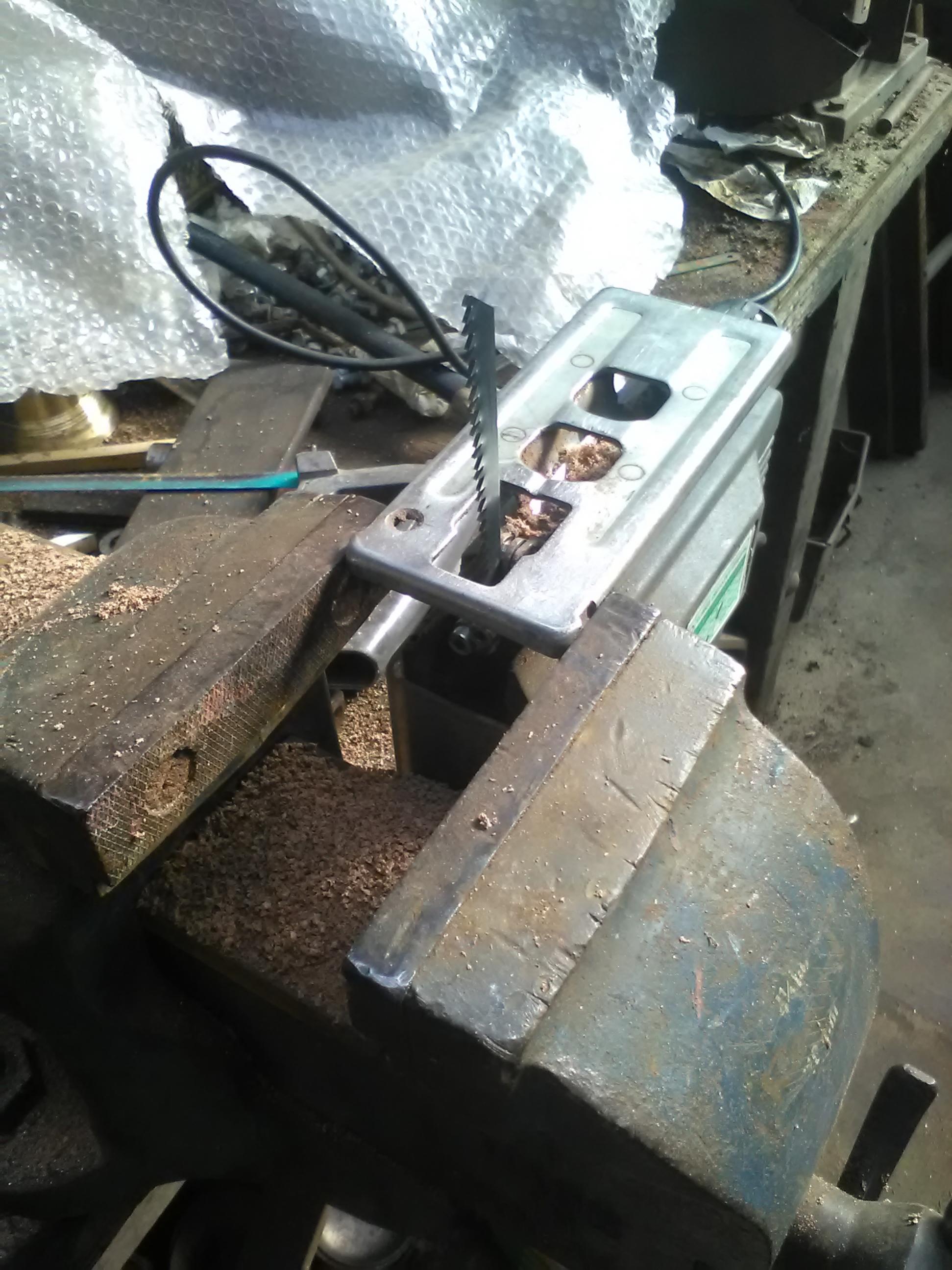

That looks quite a bit more dangerous than using it the proper way.View attachment 879352
When the jigsaw does hit the wood, why not stick it upside down in a vice ( or better make a stand ) and feed the wood through.
The blade is now sawing away, sharp edges exposed, on the same side of the wood as your hands. The risk of cutting off your hands or fingers is elevated considerably - now it's more dangerous than a table-saw or band-saw.
Why "more dangerous", rather than "as dangerous as"? If the jigsaw blade should snap in use (which is not that unusual), the broken sharp piece is now likely to be ejected at your face or eyes, rather than at your feet.
Also, if things go wrong, and the saw starts cutting into your hand, how are you going to turn it off quickly? Clamped upside down in a vice, the on-off switch is inaccessible underneath the wood you're trying to cut.
To me, the whole idea reeks of badness - just a bad, bad, bad idea. The picture of the upside-down jigsaw in the vice looks like the "before" picture, under the newspaper headline "Man Maims Himself with Upside Down Jigsaw". 😱
-Gnobuddy
I was watching some " tree house masters " or something on TV and the bloke was holding a piece of wood with one hand and using a circular saw with the other, he just missed his fingers on the unseen side. At least that wouldn't happen. It's like a table saw but you can go around corners. Having said all that I have NO objection to you pointing out safety issues, point taken.
I'm inclined to use it as it was meant to be. Bought a new one yesterday and it's a significant improvement. I still suck though 😂
