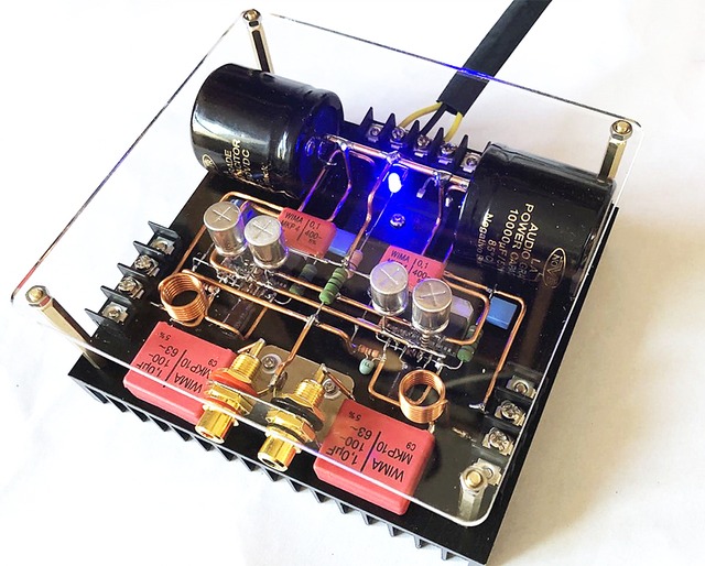

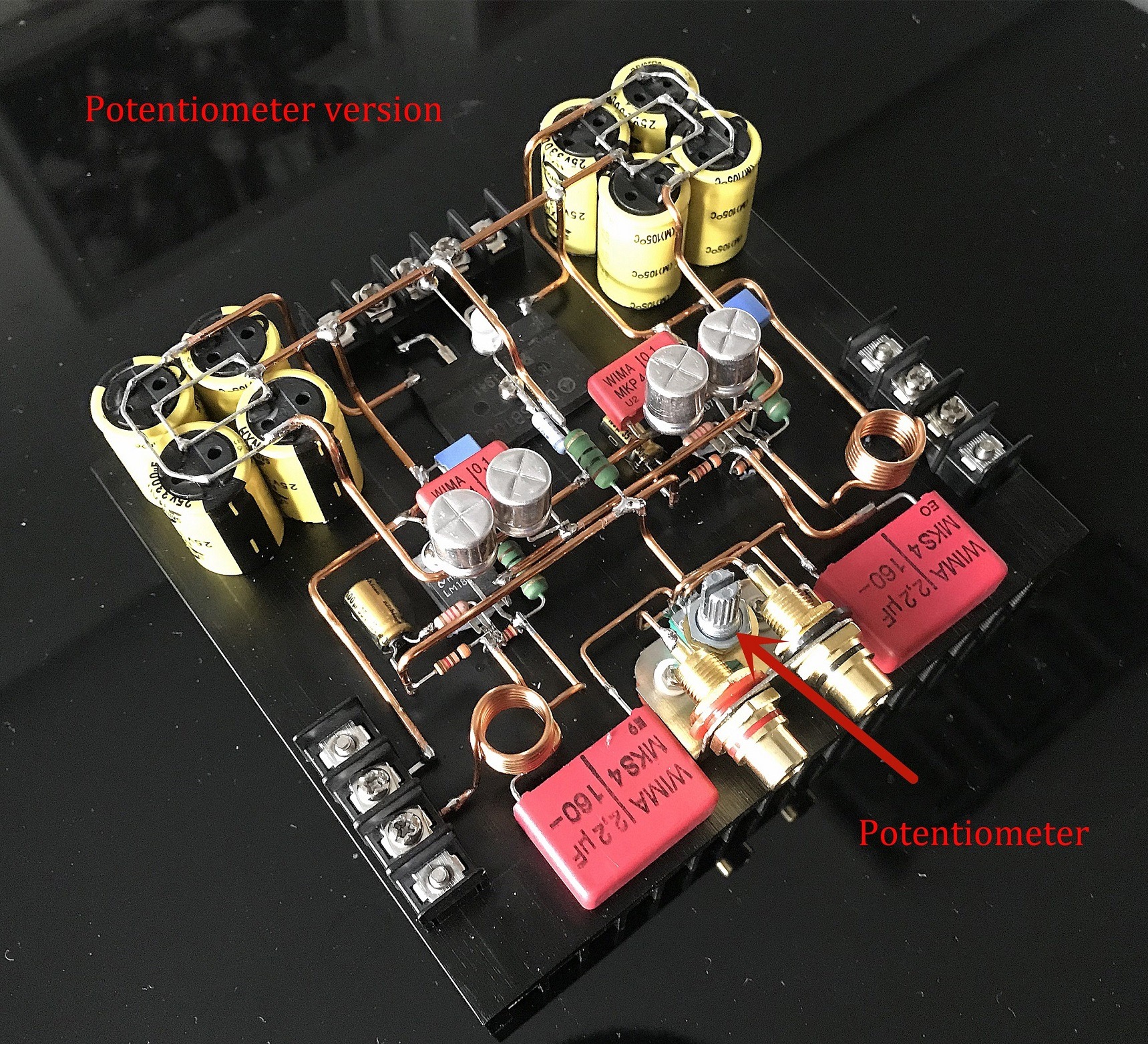

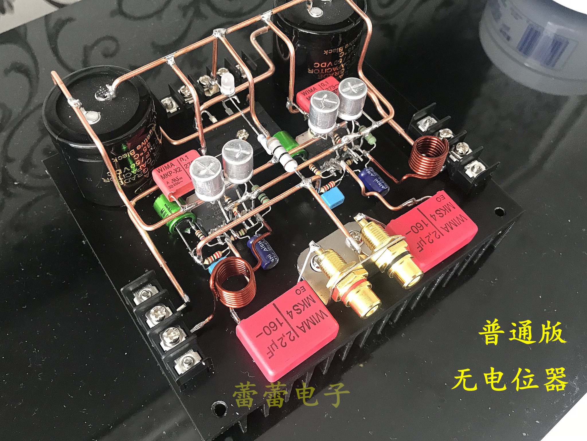

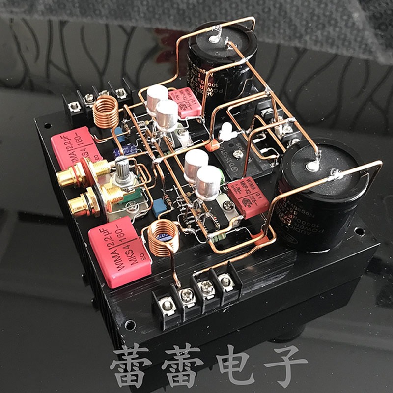

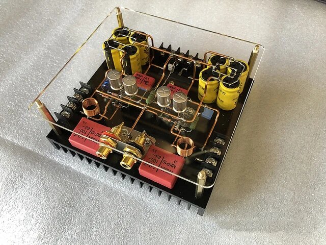

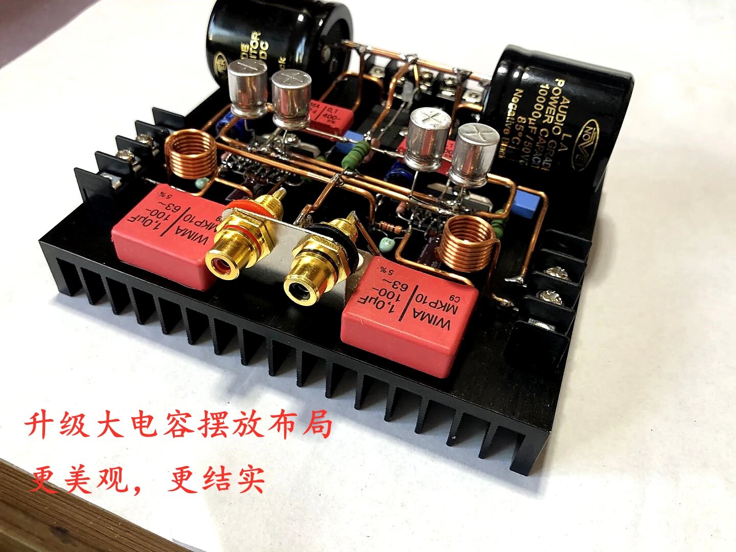

In the meantime aliexpress offers amps resp. amp modules in this kind:Are there commercial amps in this kind on the marked (check also the link in post #67) ?
https://id.aliexpress.com/i/1005002277940525.html
https://id.aliexpress.com/item/1005001732955933.html
But the term "Scaffolding Power Amplifier" isn't the right English term - so I think.
What is the right term for this kind of build and solder without PCB in colloquial English ("Scaffolding" means actually a temporary structure on the outside of a building, made usually of wooden planks and metal poles, used by workers while building, repairing, or cleaning the building) ?
Thank you for an advice.
