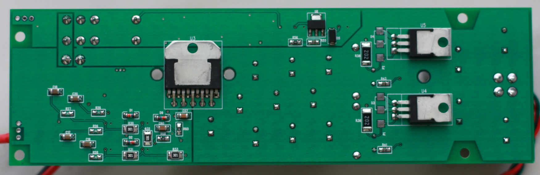

There are an extremly wide range of PCBs and Kits available for this and similar other monolitic audio amp ICs.
For me unfortunately the position of the copper conductor tracks are absolutely
disadvantageous by all examples, which are to find by Google image search - go to
audio amplifier tda7293 - Google Search
audio amplifier tda7294 - Google Search
lm3886 - Google-Suche
By this high resolution example - go to
F200# Audio Enthusiasts DIY AMP TDA7293 Amplifier Board for sale
you will see, that the positive voltage supply rail and the negative rail goes very close to the signal pads and inverted input pad for NFB. Additional there are only cheap caps for the power supply in use without screw terminals. Consequently a certain standart of sonic quality cannot be exceeded. By all showed images unfortunately this situation I note.
I am almost certain, that nothing of the showed versions from image-search sounds really good (at best like Linn's LK85 in genuine condition - i. e. with original part and wire equipment).
After performed tweacking of Linn's power amp model LK85 (equipped with TDA7294V) I observe an exceptionally enhancement by sound quality due to additional use of caps with screw terminals and change the routing of the wires for the main voltage rails.
According to my requirements four holes would be drilled in the PCB near by the pins 13 and 15 in case of TDA7293/TDA7294 (in opposite of the sensitive area). The cans of the caps must go downward (solder side/bottom side) and the screws for the caps must be screwed from the component/top side.
Then I avoid interchanges between the (very short) supply rails to the sensitive areas and I get the possibility to use top class capacitors in outlines like that from
http://www.audiocap.co.uk/ekmps/shops/audiocap/images/als30a153ke063.gif
or
http://s.eeweb.com/resized/images/r.../2011/02/15/vishaycaps-1297787376_455_332.png
instead low cost high CV versions in "snap in" outline.
Are such printed circuit boards really still not available ??
If yes, is this unbelievable. OTOH - there are too many copies of copies (clones of clones), particularly in far east.
Where is the excellent engineering from early days concerning proper PCB design ??

As for XY LM3886 kits, I do not know if this PCB can be considered as desastrous or not though the sound is five stars as is, i.e. no mods.
As long supply rails to find close to the sensitive areas PCB design is for me clearly desastrous.

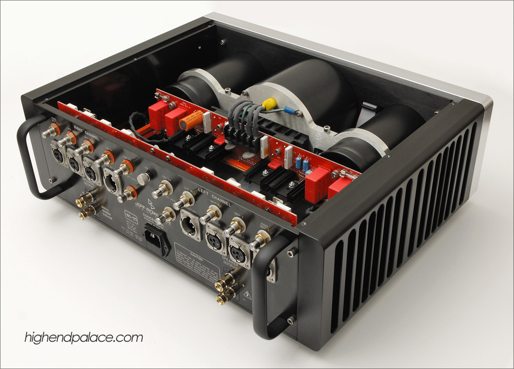

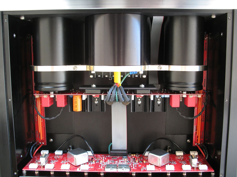

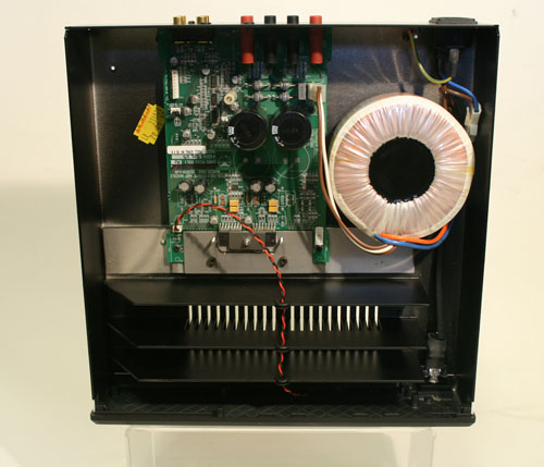

Here an other example in the right direction; Jeff Rowland's wiring diagram of Concentra/Concentra II and Model 10 looks interesting
Jeff Rowland LM3886 Amplifiers
