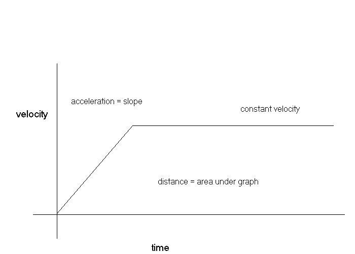

Andrew, would I be incorrect in saying that acceleration is the same thing as velocity, or is it correct to say that it's a function of acceleration, or is it proportional to accerelation ?
If I am incorrect, please explain the difference. Thanks.
--Sincerely,
acceleration, speed and distance are all related.
See attached graph of constant acceleration changing to constant velocity.
The slope of the varying velocity is a measure of the acceleration.
The flat section is the time during which the speed does not change.
The distance is time * velocity which just happens to be the area under the graph.
Fortunately the area under the sloping part of the graph also follows the same rule:- area under the graph is distance, even when the acceleration is not constant the rule still holds.
A speaker following a single tone (frequency) is following a simple harmonic motion. If you could plot the speed time graph for this it would look like a sinewave. But again the rules still follow. It's just a bit more complicated working out the slope (which is ALWAYS varying) and calculating the velocity (always varying).
Hope this helps!
