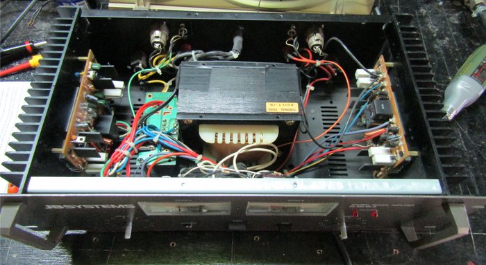

Here are more tricks. A $50 beat to death road warrior PA amp of 100-1000 watts/channel will always outperform any consumer receiver of 50 watts. Use the FM phono sections & source selector of the reciever, bypass the power section and go to directly to $50 road warrior that you refurbished. I picked up one unit for $40+freight that had been in a dumpster, the connectors and knobs were broken off. Filthy, and worthy of some serious work. The PC boards, case, heat sinks, were fine. The e-caps & fan were worn out.
