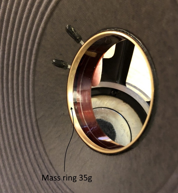

It might be of interest to know that you can get a 2235 by reconing a 2225. The motor is the same. You get the 2234 with just the new cone.
Adding a “mass ring” will take down the Fs so that you get the 2235 specs.
I have tried to measure these and I wonder how correct the factory reported specs really are.
So this discussion abow is highly interesting but do we get specs wise what we are promised.

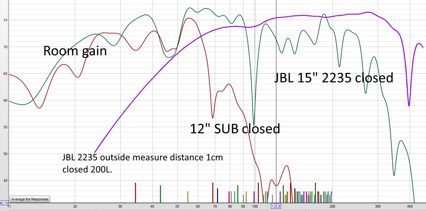

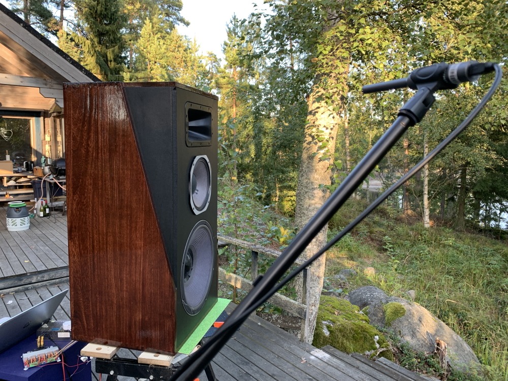

I have measured the driver and that was what i refered to. JBL does publish the driver specs. But generally I am sceptic how we'll different producers production drivers meet publiched values.

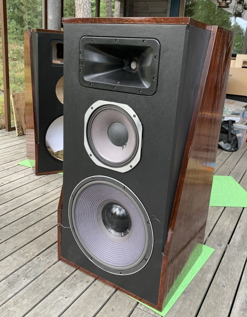

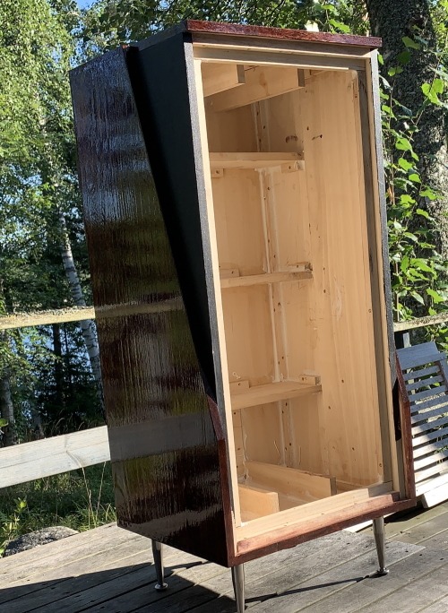

My solution putting 2235 drivers in a closed box was by design my solution. My goal was to use JBL classic drivers to see could I better my JBL monitors that I built 40 years ago. Now using active DSP FIR filtering etc.
I also have two 12” subs but they don’t ad any low end to the system as the room gain lifts the 2235 closed box curve as you can see in my post here abow.
I thik my system work well but you can always argue that there might be better options.
