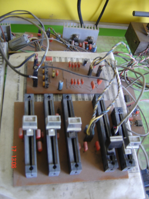

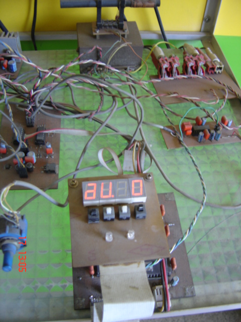

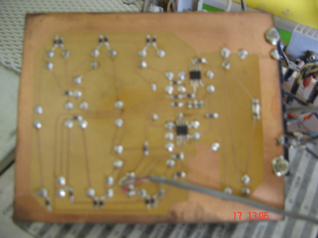

I agree in general terms with twest, but also I would add a hard misconcept about SMPS´s As I said in other posts, I have made one of them without trouble from about 12 years ago,
The problem expressed by this guy is true, but it is easily (almost for me) to compensate the loop for a too low current, and also I added some fixed loads for the supply not to enter in "hiccup mode" (Quickly start/stop switching as the load current becomes negligible). In my case, not only 6 power amplifiers are powered from a UC3842+STP7N60+TL431+BYT80 +-14V +12V +5V total 80W flyback topology, also the radio receiver (TDA7211+TDA1220B) and some TL082's in the audio path, and two early (very old) CD players and the control logic are powered from it, maintaining the minimum load necessary to not enter in hiccup mode. It is fixed 50KHz. This is the aluminium box at the last photo. No AM radio interference of appreciable high levels.
