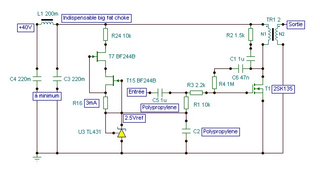

post50 shows a cascoded CCS using BF244b.
The lower jFET cannot operate well, as a CCS, when the voltage from the cascode does not suit.
Change t15 to a more suitable device. A low pinch off voltage device would be better.
Read Walt Jung.
Read Walt Jung.
